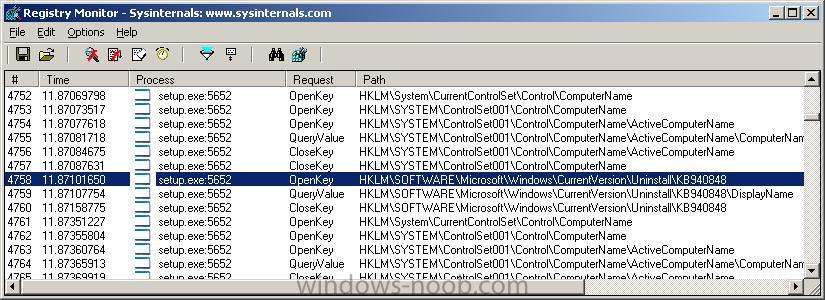

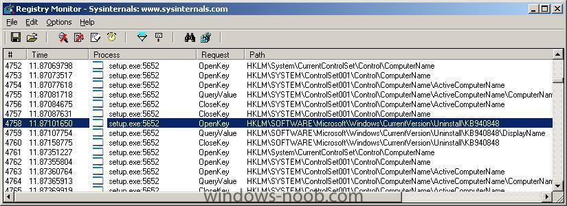

The reason for the pre-requisite test getting confused appears to be that it is looking for a string in the REGISTRY but it doesn't match what it's expecting to find
Using RegMon from sysinternals I logged the entire process while doing the pre-requisite checks and sure enough it fails to find some keys in the registry even though we have installed the correct hotfix (KB940848), the checker looks for the following key(s)
HKLM\SOFTWARE\Microsoft\Windows\CurrentVersion\Uninstall\KB940848
HKLM\SOFTWARE\Microsoft\Windows\CurrentVersion\Uninstall\KB940848\DisplayName
However they are not found because when we installed the hotfix it placed them at
HKLM\SOFTWARE\Microsoft\Windows\CurrentVersion\Uninstall\KB940848-v3
as a workaround I created a new regedit file with the exact same info as the v3 one (I exported that key in regedit).
Here's the file, rename by removing .txt and run to add this key to the registry.
uninstallkb.reg.txt
I then did a search and replace, and replaced -v3 with blank. Running the resulting reg file and then starting the pre-req checker again now finally removes the MMC warning from the list !
