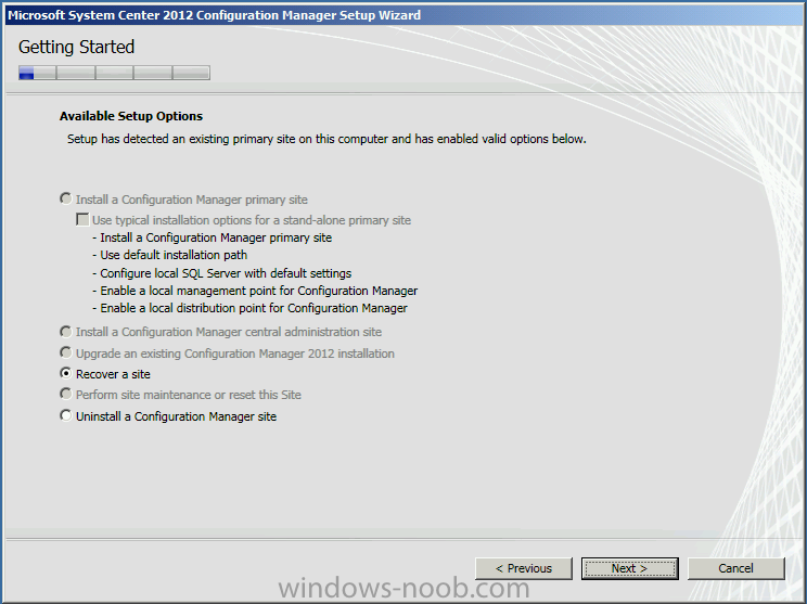

Nevermind. I didn't realize there was a Configuration Manager Setup in the start menu. I was trying to use the installation media. Duh.

I installed the evaluation version of CM 2012 RTM. Now I have a key and can't add it. All of my options are grayed out except for recover a site and uninstall.
