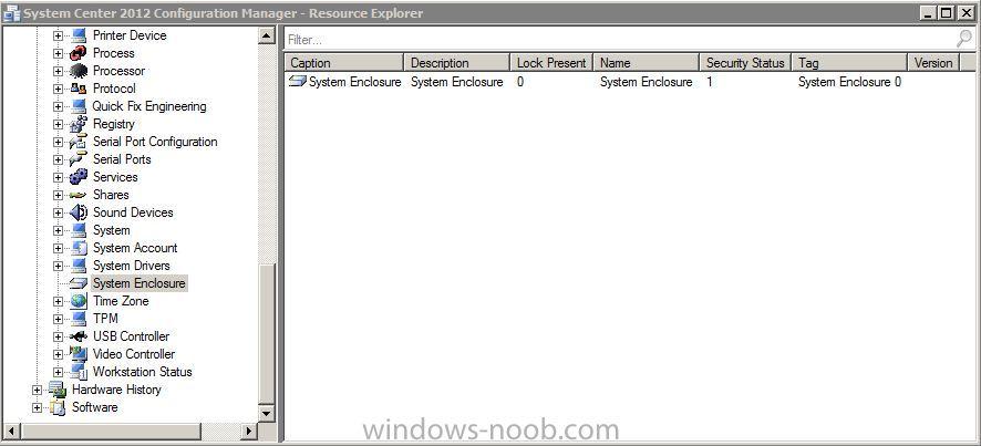

Hi there, we've been running ConfigMgr 2012 for a few months pretty successfully. We used to run ConfigMgr 2007 and had a few queries for system chassis type to locate desktops and laptops. I recreated the queries in ConfigMgr 2012 and didn't get any results. I have checked the client settings to verify that the "System Enclosure - Chassis Types" is enabled and I have verified that hardware inventory is working correctly. When I check the "System Enclosure" value in any clients' "Resource Explorer" the column headings and values don't have any of the data I would expect. I have attached a screenshot of what I see. Most of the values just say "System Enclosure" and none of them report the chassis type. Has anyone else experienced this, or have any suggestions on how to troubleshoot this issue? I really miss having the chassis type query so I'd love to get this working again. Thanks for your help!
