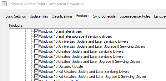

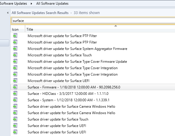

Hello, i am running sccm 1710 on windows 2016. My wsus with the system role for software update is also running on windows 2016. Under site settings for Software Update i activated the checkbox "include microsoft surface drivers...." and under products i select (see the screenshot) My Surfaces are running 1709 (fall creators update) at the moment. Now, when i take a look under "All software updates" and search for "surface" i only see one firmware update: But these updates are old. If i take a look on the MS Download Page, i found an MSI Driver Package from August, 10th. 2018. And all other updates are from 2017. Why are these updates not visible in my console ? I cant believe, that there are no newer updates for wsus available... Any idea ?
