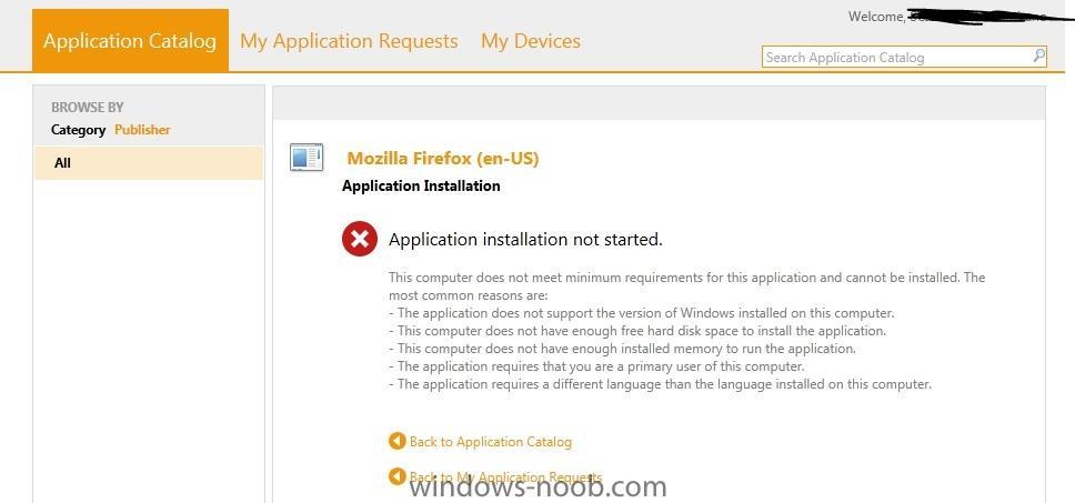

  3. I'm trying to deploy Firefox to some test clients. The test clients can see it in the ApplicationCatalog, and request/install it, but when it tries to execute, this error will pop up. Any ideas what's going on?
  4. Solved my own problem, had to reactivate .NET framework http://blogg.alltomdeployment.se/2011/11/404-error-server-error-on-cmapplicationcatalog-sccm-2012/

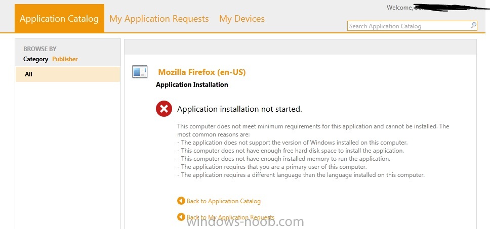

  5. I'm getting a 404 error too for the CMApplicationCatalog too. What did you do to fix this? I've uninstalled both Application roles and reinstalled them. Can someone help me out?

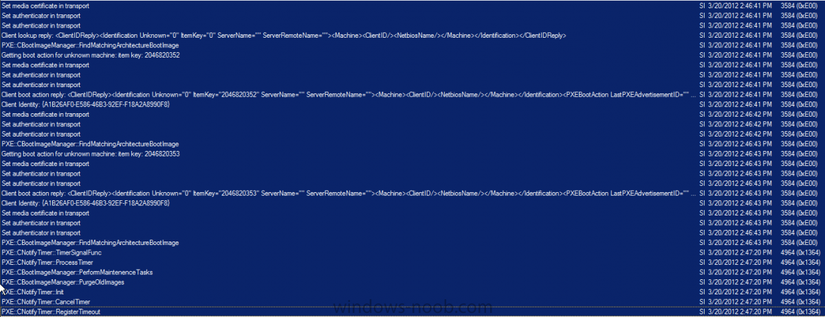

  7. 3 servers later, still abortpxe.com error. NO MAC address is visible in the SMSPXE.log file. Any help please? This issue is turning my hair gray.

  11. my smspxe.log files do not even show a MAC address :\ something is up...
  12. Ok, I built a new VM of SCCM from scratch and followed everything listed here. I cannot get PXE to boot. Still getting the abortpxe.com error. What e;se should I check, I'm pulling my hair here... 2 servers later and PXE still gives me abortpxe.com. HELP! >_<
  13. I'm trying to get this guide working. PXE is not booting, nor have I ever had it booting successfully. I always get the abortpxe.com error.
  14. No I haven't successfully booted into PXE yet, ever. I thought I screwed up in the config somewhere, so I restored from a snapshot (our SCCM 2012 RC runs on a VM), redid the configs, and still can't get it to boot from PXE. abortpxe.com is a thorn in my side right now. I've been stuck here for a few weeks, reading into this forum to see where things went wrong and stuff.
  15. I've followed this step by step, and I keep running into abortpxe.com when trying to PXE boot a Dell 755 for Windows 7 x64 capture task. SCCM2012 is running on it's own server, DHCP is running on a root-level domain controller w/ options 66 and 67 enabled, pointing to the SCCM server's IP address.
