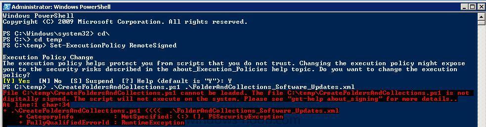

If anyone should run into the problem I ran into I follow the following to get the scripts to run. You will have to do it to both CM12Functions.ps1 and CreateFoldersAndCollections.ps1. 1. Save the script file on your computer. 2. Click Start, click My Computer, and locate the saved script file. 3. Right-click the script file, and then click Properties. 4. Click Unblock.
When I tried to execute the script I got the following error: File C:\temp\CreateFoldersAndCollections.ps1 cannot be loaded. The file C:\temp\CreateFoldersAndCollections.ps1 is not digitally signed. The script will not execute on the system. Please see "get-help about_signing" for more details.. Any suggestions?

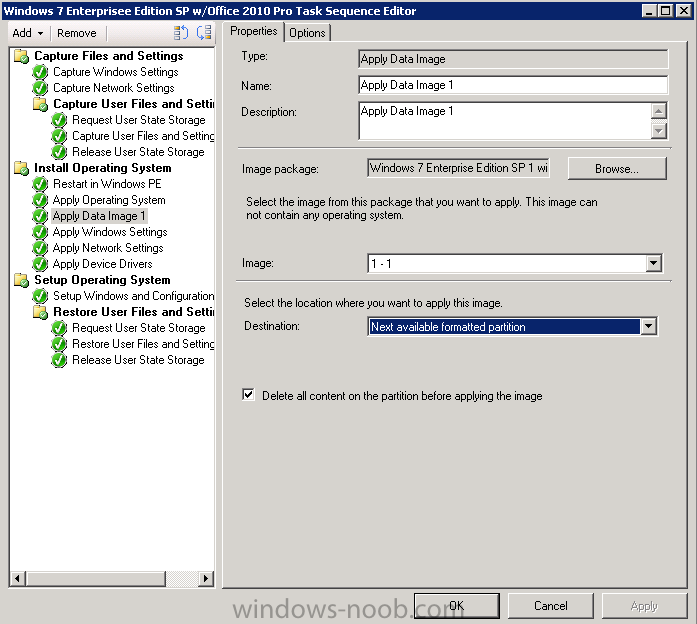

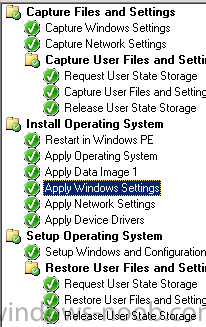

Hey guys, thanks for the help. Peter, after I delete the Apply Data Image 1 step and redeployed the TS everything worked. The first test VM was Vista and I will try XP today. Rocket Man, the reason I do not have any partitioning is that we want to preserve the exiting hard drive in case the user has data on it outside of their profile.
Hi Peter, I see you responded while I was composing the above. Using the Wizard I do not recall being given choice was to what would be installed where. I expected that SCCM would put the needed partition/volumes in the right spot. I guess I need to know what the Data Image 1 is. I am thinking it may be the hidden Win 7 boot partition but I don't know. If not then maybe it can be deleted. Oh, I told the sequence to keep the user state on the hard disk so it would not be sent to the server (to save bandwidth and speed). That might be what this is.
Ok, taking a closer look at the log file I believe this is the offending lines: <![LOG[The requested target could not be resolved to a valid volume on this computer. Check your task sequence to ensure this drive is correct and that it is being created The parameter is incorrect. (Error: 80070057; Source: Windows)]LOG]!><time="12:51:33.656+480" date="12-07-2012" component="ApplyOperatingSystem" context="" type="3" thread="1584" file="installcommon.cpp:633"> <![LOG[ResolveTarget( g_Target, g_InstallType == InstallType_DataImage, targetVolume ), HRESULT=80004005 (e:\nts_sccm_release\sms\client\osdeployment\applyos\applyos.cpp,453)]LOG]!><time="12:51:33.656+480" date="12-07-2012" component="ApplyOperatingSystem" context="" type="0" thread="1584" file="applyos.cpp:453"> <![LOG[Process completed with exit code 2147500037]LOG]!><time="12:51:33.718+480" date="12-07-2012" component="TSManager" context="" type="1" thread="1768" file="commandline.cpp:1098"> <![LOG[!--------------------------------------------------------------------------------------------!]LOG]!><time="12:51:33.734+480" date="12-07-2012" component="TSManager" context="" type="1" thread="1768" file="instruction.cxx:3011"> <![LOG[Failed to run the action: Apply Data Image 1. What exactly is Data Image 1? Is it the hidden 100MB boot partition for Windows? It appears to me that it is having a problem find the correct volume to apply the image to. Here is the setting for TS Apply Data Image 1 The Apply Operating System step before this is set to Image 2 -2
A new week and a new look at the problem. Rocket Man, thanks for your suggestion in regard to putting the Apply Data Image 1 before the OS but unfortunately it did not work. Peter in follow-up to the request of more information. I am trying to do a OS Refresh to bring Windows Vista SP1 and XP SP 3 to Windows 7 Enterprise Ed. SP 1 with SCCM 2012. We want to preserve the user's existing hard drive in case there is data stored there outside of the profile. I am using USMT 4.0 to copy and restore the user's profile from the old to the new PC. I am using a customized wim image of the OS that I created/captured myself using SCCM 2012. This image includes Office 2010 and the Windows 7 volume license key so we do not have to enter it after upgrade. Here is my Task Sequence. It fails after applying the Operating System. Here is the smsts.log: smsts1.log Thanks

I get Error Task Sequence Manager failed to execute task sequence. Code 0x80004005 after the Apply Data Image 1. When I restart the PC I end up with a freshly installed Windows 7 but no User State Data from the old install. Any thoughts or suggestions. Thanks. <![LOG[==========[ TsProgressUI started in process 1680 ]==========]LOG]!><time="08:02:14.359+480" date="12-06-2012" component="TsProgressUI" context="" type="1" thread="1676" file="winmain.cpp:329"> <![LOG[Command line: "X:\sms\bin\i386\TsProgressUI.exe" /Unregister]LOG]!><time="08:02:14.359+480" date="12-06-2012" component="TsProgressUI" context="" type="0" thread="1676" file="winmain.cpp:332"> <![LOG[unregistering COM classes]LOG]!><time="08:02:14.359+480" date="12-06-2012" component="TsProgressUI" context="" type="1" thread="1676" file="winmain.cpp:204"> <![LOG[unregistering class objects]LOG]!><time="08:02:14.375+480" date="12-06-2012" component="TsProgressUI" context="" type="1" thread="1676" file="winmain.cpp:495"> <![LOG[shutdown complete.]LOG]!><time="08:02:14.375+480" date="12-06-2012" component="TsProgressUI" context="" type="1" thread="1676" file="winmain.cpp:512"> <![LOG[Process completed with exit code 0]LOG]!><time="08:02:14.375+480" date="12-06-2012" component="TSManager" context="" type="1" thread="1776" file="commandline.cpp:1098"> <![LOG[successfully unregistered TS Progress UI.]LOG]!><time="08:02:14.375+480" date="12-06-2012" component="TSManager" context="" type="1" thread="1776" file="utils.cpp:2075"> <![LOG[g_TSManager.Run(), HRESULT=80004005 (e:\nts_sccm_release\sms\client\tasksequence\tsmanager\tsmanager.cpp,641)]LOG]!><time="08:02:14.375+480" date="12-06-2012" component="TSManager" context="" type="0" thread="1776" file="tsmanager.cpp:641"> <![LOG[Error Task Sequence Manager failed to execute task sequence. Code 0x80004005]LOG]!><time="08:02:14.375+480" date="12-06-2012" component="TSManager" context="" type="3" thread="1776" file="tsmanager.cpp:671"> <![LOG[sending error status message]LOG]!><time="08:02:14.375+480" date="12-06-2012" component="TSManager" context="" type="1" thread="1776" file="tsmanager.cpp:672"> <![LOG[MP server asd.LOCAL. Ports 80,443. CRL=false.]LOG]!><time="08:02:14.390+480" date="12-06-2012" component="TSManager" context="" type="1" thread="1776" file="utils.cpp:4855"> <![LOG[setting authenticator]LOG]!><time="08:02:14.390+480" date="12-06-2012" component="TSManager" context="" type="1" thread="1776" file="utils.cpp:4877"> <![LOG[set authenticator in transport]LOG]!><time="08:02:14.390+480" date="12-06-2012" component="TSManager" context="" type="1" thread="1776" file="libsmsmessaging.cpp:7592"> <![LOG[sending StatusMessage]LOG]!><time="08:02:14.453+480" date="12-06-2012" component="TSManager" context="" type="1" thread="1776" file="libsmsmessaging.cpp:4020"> <![LOG[setting message signatures.]LOG]!><time="08:02:14.656+480" date="12-06-2012" component="TSManager" context="" type="0" thread="1776" file="libsmsmessaging.cpp:1292"> <![LOG[setting the authenticator.]LOG]!><time="08:02:14.656+480" date="12-06-2012" component="TSManager" context="" type="0" thread="1776" file="libsmsmessaging.cpp:1322"> <![LOG[CLibSMSMessageWinHttpTransport::Send: URL: asd.LOCAL:80 CCM_POST /ccm_system/request]LOG]!><time="08:02:14.671+480" date="12-06-2012" component="TSManager" context="" type="1" thread="1776" file="libsmsmessaging.cpp:8422"> <![LOG[Request was succesful.]LOG]!><time="08:02:14.718+480" date="12-06-2012" component="TSManager" context="" type="0" thread="1776" file="libsmsmessaging.cpp:8758"> <![LOG[Finalize logging request ignored from process 1772]LOG]!><time="08:02:14.734+480" date="12-06-2012" component="TSManager" context="" type="1" thread="1776" file="tslogging.cpp:1737"> <![LOG[Process completed with exit code 2147500037]LOG]!><time="08:02:14.765+480" date="12-06-2012" component="TSMBootstrap" context="" type="1" thread="1732" file="commandline.cpp:1098"> <![LOG[Exiting with return code 0x80004005]LOG]!><time="08:02:14.765+480" date="12-06-2012" component="TSMBootstrap" context="" type="1" thread="1732" file="tsmbootstrap.cpp:1032"> <![LOG[Execution complete.]LOG]!><time="08:02:14.812+480" date="12-06-2012" component="TSBootShell" context="" type="1" thread="752" file="bootshell.cpp:616"> <![LOG[Finalizing logging from process 740]LOG]!><time="08:02:14.812+480" date="12-06-2012" component="TSBootShell" context="" type="1" thread="752" file="tslogging.cpp:1741"> <![LOG[Finalizing logs to root of first available drive]LOG]!><time="08:02:14.812+480" date="12-06-2012" component="TSBootShell" context="" type="1" thread="752" file="tslogging.cpp:1583"> <![LOG[successfully finalized logs to C:\SMSTSLog]LOG]!><time="08:02:14.843+480" date="12-06-2012" component="TSBootShell" context="" type="1" thread="752" file="tslogging.cpp:1640"> <![LOG[Cleaning up task sequencing logging configuration.]LOG]!><time="08:02:14.843+480" date="12-06-2012" component="TSBootShell" context="" type="0" thread="752" file="tslogging.cpp:584">
