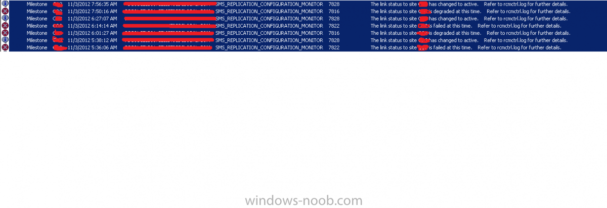

Hi all, I am very grateful for your valuable support, thanks to you I learned much. Now I have a very important inquiry, I have one primary and several secondary site with replication, all going well, but there is nothing but one is giving me problems with replication apparently connectivity problems, I checked the link channel or constant pinging such a network and packet loss are minimal but well, very little, so this rule because there are other sites with more losses and the replication process is well maintained with them despite the lost, no longer to do because everything is well, if you need advice, no longer to review, here I leave a picture replication Monitor and log RCMCTRL.LOG .. I'm sure that will help me =============================================================================================================================================================================================================================================================== Processing Replication success. SMS_REPLICATION_CONFIGURATION_MONITOR 11/3/2012 2:18:35 AM 4928 (0x1340) Rcm control is waiting for file change notification or timeout after 120 seconds. SMS_REPLICATION_CONFIGURATION_MONITOR 11/3/2012 2:18:36 AM 4928 (0x1340) DRS sync started. SMS_REPLICATION_CONFIGURATION_MONITOR 11/3/2012 2:19:08 AM 6672 (0x1A10) DRS change application started. SMS_REPLICATION_CONFIGURATION_MONITOR 11/3/2012 2:19:08 AM 8656 (0x21D0) Launching 3 sprocs on queue ConfigMgrDRSQueue and 0 sprocs on queue ConfigMgrDRSSiteQueue. SMS_REPLICATION_CONFIGURATION_MONITOR 11/3/2012 2:19:08 AM 8656 (0x21D0) There are 3 Drs Activations sprocs running. SMS_REPLICATION_CONFIGURATION_MONITOR 11/3/2012 2:19:08 AM 8656 (0x21D0) DRS sync started. SMS_REPLICATION_CONFIGURATION_MONITOR 11/3/2012 2:20:08 AM 6672 (0x1A10) DRS change application started. SMS_REPLICATION_CONFIGURATION_MONITOR 11/3/2012 2:20:09 AM 8656 (0x21D0) Launching 3 sprocs on queue ConfigMgrDRSQueue and 0 sprocs on queue ConfigMgrDRSSiteQueue. SMS_REPLICATION_CONFIGURATION_MONITOR 11/3/2012 2:20:09 AM 8656 (0x21D0) The asynchronous command finished with return message: [spDRSActivation finished at 11/3/2012 2:20:05 AM. End execute query finished at 11/3/2012 2:20:05 AM.]. SMS_REPLICATION_CONFIGURATION_MONITOR 11/3/2012 2:20:09 AM 8656 (0x21D0) The asynchronous command finished with return message: [spDRSActivation finished at 11/3/2012 2:20:06 AM. End execute query finished at 11/3/2012 2:20:06 AM.]. SMS_REPLICATION_CONFIGURATION_MONITOR 11/3/2012 2:20:09 AM 8656 (0x21D0) There are 3 Drs Activations sprocs running. SMS_REPLICATION_CONFIGURATION_MONITOR 11/3/2012 2:20:09 AM 8656 (0x21D0) Wait for inbox notification timed out. SMS_REPLICATION_CONFIGURATION_MONITOR 11/3/2012 2:20:36 AM 4928 (0x1340) Cleaning the RCM inbox if there are any *.RCM files for further change notifications.... SMS_REPLICATION_CONFIGURATION_MONITOR 11/3/2012 2:20:36 AM 4928 (0x1340) Initializing RCM. SMS_REPLICATION_CONFIGURATION_MONITOR 11/3/2012 2:20:36 AM 4928 (0x1340) Processing Replication SMS_REPLICATION_CONFIGURATION_MONITOR 11/3/2012 2:20:36 AM 4928 (0x1340) Running configuration EnsureServiceBrokerEnabled. SMS_REPLICATION_CONFIGURATION_MONITOR 11/3/2012 2:20:36 AM 4928 (0x1340) Running configuration EnsureServiceBrokerQueuesAreEnabled. SMS_REPLICATION_CONFIGURATION_MONITOR 11/3/2012 2:20:36 AM 4928 (0x1340) Processing replication pattern global_proxy. SMS_REPLICATION_CONFIGURATION_MONITOR 11/3/2012 2:20:36 AM 4928 (0x1340) Summarizing all replication links for monitoring UI. SMS_REPLICATION_CONFIGURATION_MONITOR 11/3/2012 2:20:37 AM 4928 (0x1340) The current site status: ReplicationActive. SMS_REPLICATION_CONFIGURATION_MONITOR 11/3/2012 2:20:37 AM 4928 (0x1340) Processing Replication success. SMS_REPLICATION_CONFIGURATION_MONITOR 11/3/2012 2:20:37 AM 4928 (0x1340) Rcm control is waiting for file change notification or timeout after 120 seconds. SMS_REPLICATION_CONFIGURATION_MONITOR 11/3/2012 2:20:38 AM 4928 (0x1340) DRS sync started. SMS_REPLICATION_CONFIGURATION_MONITOR 11/3/2012 2:21:08 AM 6672 (0x1A10) DRS change application started. SMS_REPLICATION_CONFIGURATION_MONITOR 11/3/2012 2:21:09 AM 8656 (0x21D0) Launching 3 sprocs on queue ConfigMgrDRSQueue and 0 sprocs on queue ConfigMgrDRSSiteQueue. SMS_REPLICATION_CONFIGURATION_MONITOR 11/3/2012 2:21:09 AM 8656 (0x21D0) There are 3 Drs Activations sprocs running. SMS_REPLICATION_CONFIGURATION_MONITOR 11/3/2012 2:21:09 AM 8656 (0x21D0) DRS sync started. SMS_REPLICATION_CONFIGURATION_MONITOR 11/3/2012 2:22:09 AM 6672 (0x1A10) DRS change application started. SMS_REPLICATION_CONFIGURATION_MONITOR 11/3/2012 2:22:09 AM 8656 (0x21D0) Launching 3 sprocs on queue ConfigMgrDRSQueue and 0 sprocs on queue ConfigMgrDRSSiteQueue. SMS_REPLICATION_CONFIGURATION_MONITOR 11/3/2012 2:22:09 AM 8656 (0x21D0) The asynchronous command finished with return message: [spDRSActivation finished at 11/3/2012 2:21:30 AM. End execute query finished at 11/3/2012 2:21:30 AM.]. SMS_REPLICATION_CONFIGURATION_MONITOR 11/3/2012 2:22:09 AM 8656 (0x21D0) There are 3 Drs Activations sprocs running. SMS_REPLICATION_CONFIGURATION_MONITOR 11/3/2012 2:22:09 AM 8656 (0x21D0) Wait for inbox notification timed out. SMS_REPLICATION_CONFIGURATION_MONITOR 11/3/2012 2:22:38 AM 4928 (0x1340) Cleaning the RCM inbox if there are any *.RCM files for further change notifications.... SMS_REPLICATION_CONFIGURATION_MONITOR 11/3/2012 2:22:38 AM 4928 (0x1340) Initializing RCM. SMS_REPLICATION_CONFIGURATION_MONITOR 11/3/2012 2:22:38 AM 4928 (0x1340) Processing Replication SMS_REPLICATION_CONFIGURATION_MONITOR 11/3/2012 2:22:38 AM 4928 (0x1340) Running configuration EnsureServiceBrokerEnabled. SMS_REPLICATION_CONFIGURATION_MONITOR 11/3/2012 2:22:38 AM 4928 (0x1340) Running configuration EnsureServiceBrokerQueuesAreEnabled. SMS_REPLICATION_CONFIGURATION_MONITOR 11/3/2012 2:22:38 AM 4928 (0x1340) Processing replication pattern global_proxy. SMS_REPLICATION_CONFIGURATION_MONITOR 11/3/2012 2:22:38 AM 4928 (0x1340) Summarizing all replication links for monitoring UI. SMS_REPLICATION_CONFIGURATION_MONITOR 11/3/2012 2:22:38 AM 4928 (0x1340) The current site status: ReplicationActive. SMS_REPLICATION_CONFIGURATION_MONITOR 11/3/2012 2:22:39 AM 4928 (0x1340) Processing Replication success. SMS_REPLICATION_CONFIGURATION_MONITOR 11/3/2012 2:22:39 AM 4928 (0x1340) Rcm control is waiting for file change notification or timeout after 120 seconds. SMS_REPLICATION_CONFIGURATION_MONITOR 11/3/2012 2:22:40 AM 4928 (0x1340) DRS sync started. SMS_REPLICATION_CONFIGURATION_MONITOR 11/3/2012 2:23:09 AM 6672 (0x1A10) DRS change application started. SMS_REPLICATION_CONFIGURATION_MONITOR 11/3/2012 2:23:09 AM 8656 (0x21D0) Launching 3 sprocs on queue ConfigMgrDRSQueue and 0 sprocs on queue ConfigMgrDRSSiteQueue. SMS_REPLICATION_CONFIGURATION_MONITOR 11/3/2012 2:23:09 AM 8656 (0x21D0) There are 3 Drs Activations sprocs running. SMS_REPLICATION_CONFIGURATION_MONITOR 11/3/2012 2:23:09 AM 8656 (0x21D0) DRS sync started. SMS_REPLICATION_CONFIGURATION_MONITOR 11/3/2012 2:24:09 AM 6672 (0x1A10) DRS change application started. SMS_REPLICATION_CONFIGURATION_MONITOR 11/3/2012 2:24:09 AM 8656 (0x21D0) Launching 3 sprocs on queue ConfigMgrDRSQueue and 0 sprocs on queue ConfigMgrDRSSiteQueue. SMS_REPLICATION_CONFIGURATION_MONITOR 11/3/2012 2:24:09 AM 8656 (0x21D0) The asynchronous command finished with return message: [spDRSActivation finished at 11/3/2012 2:23:58 AM. End execute query finished at 11/3/2012 2:23:58 AM.]. SMS_REPLICATION_CONFIGURATION_MONITOR 11/3/2012 2:24:09 AM 8656 (0x21D0) The asynchronous command finished with return message: [spDRSActivation finished at 11/3/2012 2:23:59 AM. End execute query finished at 11/3/2012 2:23:59 AM.]. SMS_REPLICATION_CONFIGURATION_MONITOR 11/3/2012 2:24:09 AM 8656 (0x21D0) There are 3 Drs Activations sprocs running. SMS_REPLICATION_CONFIGURATION_MONITOR 11/3/2012 2:24:09 AM 8656 (0x21D0) Wait for inbox notification timed out. SMS_REPLICATION_CONFIGURATION_MONITOR 11/3/2012 2:24:40 AM 4928 (0x1340) Cleaning the RCM inbox if there are any *.RCM files for further change notifications.... SMS_REPLICATION_CONFIGURATION_MONITOR 11/3/2012 2:24:40 AM 4928 (0x1340) Initializing RCM. SMS_REPLICATION_CONFIGURATION_MONITOR 11/3/2012 2:24:40 AM 4928 (0x1340) Processing Replication SMS_REPLICATION_CONFIGURATION_MONITOR 11/3/2012 2:24:40 AM 4928 (0x1340) Running configuration EnsureServiceBrokerEnabled. SMS_REPLICATION_CONFIGURATION_MONITOR 11/3/2012 2:24:40 AM 4928 (0x1340) Running configuration EnsureServiceBrokerQueuesAreEnabled. SMS_REPLICATION_CONFIGURATION_MONITOR 11/3/2012 2:24:40 AM 4928 (0x1340) Processing replication pattern global_proxy. SMS_REPLICATION_CONFIGURATION_MONITOR 11/3/2012 2:24:40 AM 4928 (0x1340) Summarizing all replication links for monitoring UI. SMS_REPLICATION_CONFIGURATION_MONITOR 11/3/2012 2:24:40 AM 4928 (0x1340) The current site status: ReplicationActive. SMS_REPLICATION_CONFIGURATION_MONITOR 11/3/2012 2:24:40 AM 4928 (0x1340) Processing Replication success. SMS_REPLICATION_CONFIGURATION_MONITOR 11/3/2012 2:24:40 AM 4928 (0x1340) Rcm control is waiting for file change notification or timeout after 120 seconds. SMS_REPLICATION_CONFIGURATION_MONITOR 11/3/2012 2:24:41 AM 4928 (0x1340) DRS sync started. SMS_REPLICATION_CONFIGURATION_MONITOR 11/3/2012 2:25:09 AM 6672 (0x1A10) DRS change application started. SMS_REPLICATION_CONFIGURATION_MONITOR 11/3/2012 2:25:10 AM 8656 (0x21D0) Launching 3 sprocs on queue ConfigMgrDRSQueue and 0 sprocs on queue ConfigMgrDRSSiteQueue. SMS_REPLICATION_CONFIGURATION_MONITOR 11/3/2012 2:25:10 AM 8656 (0x21D0) There are 3 Drs Activations sprocs running. SMS_REPLICATION_CONFIGURATION_MONITOR 11/3/2012 2:25:10 AM 8656 (0x21D0) DRS sync started. SMS_REPLICATION_CONFIGURATION_MONITOR 11/3/2012 2:26:09 AM 6672 (0x1A10) DRS change application started. SMS_REPLICATION_CONFIGURATION_MONITOR 11/3/2012 2:26:10 AM 8656 (0x21D0) Launching 3 sprocs on queue ConfigMgrDRSQueue and 0 sprocs on queue ConfigMgrDRSSiteQueue. SMS_REPLICATION_CONFIGURATION_MONITOR 11/3/2012 2:26:10 AM 8656 (0x21D0) The asynchronous command finished with return message: [spDRSActivation finished at 11/3/2012 2:25:25 AM. End execute query finished at 11/3/2012 2:25:25 AM.]. SMS_REPLICATION_CONFIGURATION_MONITOR 11/3/2012 2:26:10 AM 8656 (0x21D0) There are 3 Drs Activations sprocs running. SMS_REPLICATION_CONFIGURATION_MONITOR 11/3/2012 2:26:10 AM 8656 (0x21D0) Wait for inbox notification timed out. SMS_REPLICATION_CONFIGURATION_MONITOR 11/3/2012 2:26:42 AM 4928 (0x1340) Cleaning the RCM inbox if there are any *.RCM files for further change notifications.... SMS_REPLICATION_CONFIGURATION_MONITOR 11/3/2012 2:26:42 AM 4928 (0x1340) Initializing RCM. SMS_REPLICATION_CONFIGURATION_MONITOR 11/3/2012 2:26:42 AM 4928 (0x1340) Processing Replication SMS_REPLICATION_CONFIGURATION_MONITOR 11/3/2012 2:26:42 AM 4928 (0x1340) Running configuration EnsureServiceBrokerEnabled. SMS_REPLICATION_CONFIGURATION_MONITOR 11/3/2012 2:26:42 AM 4928 (0x1340) Running configuration EnsureServiceBrokerQueuesAreEnabled. SMS_REPLICATION_CONFIGURATION_MONITOR 11/3/2012 2:26:42 AM 4928 (0x1340) Processing replication pattern global_proxy. SMS_REPLICATION_CONFIGURATION_MONITOR 11/3/2012 2:26:42 AM 4928 (0x1340) Summarizing all replication links for monitoring UI. SMS_REPLICATION_CONFIGURATION_MONITOR 11/3/2012 2:26:42 AM 4928 (0x1340) The current site status: ReplicationActive. SMS_REPLICATION_CONFIGURATION_MONITOR 11/3/2012 2:26:42 AM 4928 (0x1340) Processing Replication success. SMS_REPLICATION_CONFIGURATION_MONITOR 11/3/2012 2:26:42 AM 4928 (0x1340) Rcm control is waiting for file change notification or timeout after 120 seconds. SMS_REPLICATION_CONFIGURATION_MONITOR 11/3/2012 2:26:43 AM 4928 (0x1340) DRS sync started. SMS_REPLICATION_CONFIGURATION_MONITOR 11/3/2012 2:27:10 AM 6672 (0x1A10) DRS change application started. SMS_REPLICATION_CONFIGURATION_MONITOR 11/3/2012 2:27:10 AM 8656 (0x21D0) Launching 3 sprocs on queue ConfigMgrDRSQueue and 0 sprocs on queue ConfigMgrDRSSiteQueue. SMS_REPLICATION_CONFIGURATION_MONITOR 11/3/2012 2:27:10 AM 8656 (0x21D0) There are 3 Drs Activations sprocs running. SMS_REPLICATION_CONFIGURATION_MONITOR 11/3/2012 2:27:10 AM 8656 (0x21D0) DRS sync started. SMS_REPLICATION_CONFIGURATION_MONITOR 11/3/2012 2:28:10 AM 6672 (0x1A10) DRS change application started. SMS_REPLICATION_CONFIGURATION_MONITOR 11/3/2012 2:28:10 AM 8656 (0x21D0) Launching 3 sprocs on queue ConfigMgrDRSQueue and 0 sprocs on queue ConfigMgrDRSSiteQueue. SMS_REPLICATION_CONFIGURATION_MONITOR 11/3/2012 2:28:10 AM 8656 (0x21D0) The asynchronous command finished with return message: [spDRSActivation finished at 11/3/2012 2:27:29 AM. End execute query finished at 11/3/2012 2:27:29 AM.]. SMS_REPLICATION_CONFIGURATION_MONITOR 11/3/2012 2:28:10 AM 8656 (0x21D0) The asynchronous command finished with return message: [spDRSActivation finished at 11/3/2012 2:27:14 AM. End execute query finished at 11/3/2012 2:27:14 AM.]. SMS_REPLICATION_CONFIGURATION_MONITOR 11/3/2012 2:28:10 AM 8656 (0x21D0) There are 3 Drs Activations sprocs running. SMS_REPLICATION_CONFIGURATION_MONITOR 11/3/2012 2:28:10 AM 8656 (0x21D0) Wait for inbox notification timed out. SMS_REPLICATION_CONFIGURATION_MONITOR 11/3/2012 2:28:43 AM 4928 (0x1340) Cleaning the RCM inbox if there are any *.RCM files for further change notifications.... SMS_REPLICATION_CONFIGURATION_MONITOR 11/3/2012 2:28:43 AM 4928 (0x1340) Initializing RCM. SMS_REPLICATION_CONFIGURATION_MONITOR 11/3/2012 2:28:43 AM 4928 (0x1340) Processing Replication SMS_REPLICATION_CONFIGURATION_MONITOR 11/3/2012 2:28:44 AM 4928 (0x1340) Running configuration EnsureServiceBrokerEnabled. SMS_REPLICATION_CONFIGURATION_MONITOR 11/3/2012 2:28:44 AM 4928 (0x1340) Running configuration EnsureServiceBrokerQueuesAreEnabled. SMS_REPLICATION_CONFIGURATION_MONITOR 11/3/2012 2:28:44 AM 4928 (0x1340) Running configuration RemoveDuplicateSSBServices. SMS_REPLICATION_CONFIGURATION_MONITOR 11/3/2012 2:28:44 AM 4928 (0x1340) Processing replication pattern global_proxy. SMS_REPLICATION_CONFIGURATION_MONITOR 11/3/2012 2:28:44 AM 4928 (0x1340) Summarizing all replication links for monitoring UI. SMS_REPLICATION_CONFIGURATION_MONITOR 11/3/2012 2:28:44 AM 4928 (0x1340) The current site status: ReplicationActive. SMS_REPLICATION_CONFIGURATION_MONITOR 11/3/2012 2:28:44 AM 4928 (0x1340) Processing Replication success. SMS_REPLICATION_CONFIGURATION_MONITOR 11/3/2012 2:28:44 AM 4928 (0x1340) Rcm control is waiting for file change notification or timeout after 120 seconds. SMS_REPLICATION_CONFIGURATION_MONITOR 11/3/2012 2:28:45 AM 4928 (0x1340) DRS sync started. SMS_REPLICATION_CONFIGURATION_MONITOR 11/3/2012 2:29:10 AM 6672 (0x1A10) DRS change application started. SMS_REPLICATION_CONFIGURATION_MONITOR 11/3/2012 2:29:10 AM 8656 (0x21D0) Launching 3 sprocs on queue ConfigMgrDRSQueue and 0 sprocs on queue ConfigMgrDRSSiteQueue. SMS_REPLICATION_CONFIGURATION_MONITOR 11/3/2012 2:29:10 AM 8656 (0x21D0) There are 3 Drs Activations sprocs running. SMS_REPLICATION_CONFIGURATION_MONITOR 11/3/2012 2:29:10 AM 8656 (0x21D0) DRS sync started. SMS_REPLICATION_CONFIGURATION_MONITOR 11/3/2012 2:30:10 AM 6672 (0x1A10) DRS change application started. SMS_REPLICATION_CONFIGURATION_MONITOR 11/3/2012 2:30:11 AM 8656 (0x21D0) Launching 3 sprocs on queue ConfigMgrDRSQueue and 0 sprocs on queue ConfigMgrDRSSiteQueue. SMS_REPLICATION_CONFIGURATION_MONITOR 11/3/2012 2:30:11 AM 8656 (0x21D0) The asynchronous command finished with retur :wacko: :wacko: :wacko: -

Hello everyone, thank you for your valuable support, thanks to you I have learned a lot about SCCM 2012, I have a hierarchy with a primary and some secondary site, there is a way to change the Replication Monitor, I mean the time, that if the network fails 2 or 3 seconds warning is not generated, and that has happened. apparently I have connectivity issues with a point, but not always, and when it occurs is for 1 0 2 seconds and the alert is generated, it really does not need constant replication, and deployment I have done, but there's always time to point out secondary site always happens once or twice a day I get error only for 1 or 2 seconds, you can extend this time? I recommend for the Replication Monitor?, after the timeout, but is uncomfortable resets see red flags for this message time-out so soon. The replica analyzer runs well, there is no problem with Wait for inbox notification timed out. SMS_REPLICATION_CONFIGURATION_MONITOR 31/10/2012 9:59:27 1484 (0x05CC) Cleaning the RCM inbox if there are any *.RCM files for further change notifications.... SMS_REPLICATION_CONFIGURATION_MONITOR 31/10/2012 9:59:27 1484 (0x05CC) Initializing RCM. SMS_REPLICATION_CONFIGURATION_MONITOR 31/10/2012 9:59:27 1484 (0x05CC) Processing Replication SMS_REPLICATION_CONFIGURATION_MONITOR 31/10/2012 9:59:28 1484 (0x05CC) Running configuration EnsureServiceBrokerEnabled. SMS_REPLICATION_CONFIGURATION_MONITOR 31/10/2012 9:59:28 1484 (0x05CC) Running configuration EnsureServiceBrokerQueuesAreEnabled. SMS_REPLICATION_CONFIGURATION_MONITOR 31/10/2012 9:59:28 1484 (0x05CC) Running configuration RemoveDuplicateSSBServices. SMS_REPLICATION_CONFIGURATION_MONITOR 31/10/2012 9:59:28 1484 (0x05CC) Processing replication pattern global_proxy. SMS_REPLICATION_CONFIGURATION_MONITOR 31/10/2012 9:59:28 1484 (0x05CC) Processing replication pattern procedureForwarder. SMS_REPLICATION_CONFIGURATION_MONITOR 31/10/2012 9:59:29 1484 (0x05CC) Running configuration ConfigureLinkedServers. SMS_REPLICATION_CONFIGURATION_MONITOR 31/10/2012 9:59:29 1484 (0x05CC) Found 1 servers that needs to be linked. SMS_REPLICATION_CONFIGURATION_MONITOR 31/10/2012 9:59:29 1484 (0x05CC) Summarizing all replication links for monitoring UI. SMS_REPLICATION_CONFIGURATION_MONITOR 31/10/2012 9:59:36 1484 (0x05CC) The current site status: ReplicationActive. SMS_REPLICATION_CONFIGURATION_MONITOR 31/10/2012 9:59:36 1484 (0x05CC) Processing Replication success. SMS_REPLICATION_CONFIGURATION_MONITOR 31/10/2012 9:59:36 1484 (0x05CC) Rcm control is waiting for file change notification or timeout after 120 seconds. SMS_REPLICATION_CONFIGURATION_MONITOR 31/10/2012 9:59:37 1484 (0x05CC) DRS sync started. SMS_REPLICATION_CONFIGURATION_MONITOR 31/10/2012 10:00:23 3904 (0x0F40) DRS change application started. SMS_REPLICATION_CONFIGURATION_MONITOR 31/10/2012 10:00:27 2944 (0x0B80) Launching 2 sprocs on queue ConfigMgrDRSQueue and 0 sprocs on queue ConfigMgrDRSSiteQueue. SMS_REPLICATION_CONFIGURATION_MONITOR 31/10/2012 10:00:27 2944 (0x0B80) There are 2 Drs Activations sprocs running. SMS_REPLICATION_CONFIGURATION_MONITOR 31/10/2012 10:00:28 2944 (0x0B80) DRS sync started. SMS_REPLICATION_CONFIGURATION_MONITOR 31/10/2012 10:01:25 3904 (0x0F40) DRS change application started. SMS_REPLICATION_CONFIGURATION_MONITOR 31/10/2012 10:01:28 2944 (0x0B80) Launching 2 sprocs on queue ConfigMgrDRSQueue and 0 sprocs on queue ConfigMgrDRSSiteQueue. SMS_REPLICATION_CONFIGURATION_MONITOR 31/10/2012 10:01:28 2944 (0x0B80) There are 2 Drs Activations sprocs running. SMS_REPLICATION_CONFIGURATION_MONITOR 31/10/2012 10:01:28 2944 (0x0B80) Wait for inbox notification timed out. SMS_REPLICATION_CONFIGURATION_MONITOR 31/10/2012 10:01:37 1484 (0x05CC) Cleaning the RCM inbox if there are any *.RCM files for further change notifications.... SMS_REPLICATION_CONFIGURATION_MONITOR 31/10/2012 10:01:37 1484 (0x05CC) Initializing RCM. SMS_REPLICATION_CONFIGURATION_MONITOR 31/10/2012 10:01:37 1484 (0x05CC) Processing Replication SMS_REPLICATION_CONFIGURATION_MONITOR 31/10/2012 10:01:37 1484 (0x05CC) Running configuration EnsureServiceBrokerEnabled. SMS_REPLICATION_CONFIGURATION_MONITOR 31/10/2012 10:01:38 1484 (0x05CC) Running configuration EnsureServiceBrokerQueuesAreEnabled. SMS_REPLICATION_CONFIGURATION_MONITOR 31/10/2012 10:01:38 1484 (0x05CC) Processing replication pattern global_proxy. SMS_REPLICATION_CONFIGURATION_MONITOR 31/10/2012 10:01:38 1484 (0x05CC) Processing replication pattern procedureForwarder. SMS_REPLICATION_CONFIGURATION_MONITOR 31/10/2012 10:01:38 1484 (0x05CC) Running configuration ConfigureLinkedServers. SMS_REPLICATION_CONFIGURATION_MONITOR 31/10/2012 10:01:38 1484 (0x05CC) Found 1 servers that needs to be linked. SMS_REPLICATION_CONFIGURATION_MONITOR 31/10/2012 10:01:38 1484 (0x05CC) Summarizing all replication links for monitoring UI. SMS_REPLICATION_CONFIGURATION_MONITOR 31/10/2012 10:01:40 1484 (0x05CC) The current site status: ReplicationActive. SMS_REPLICATION_CONFIGURATION_MONITOR 31/10/2012 10:01:41 1484 (0x05CC) Processing Replication success. SMS_REPLICATION_CONFIGURATION_MONITOR 31/10/2012 10:01:41 1484 (0x05CC) Rcm control is waiting for file change notification or timeout after 120 seconds. SMS_REPLICATION_CONFIGURATION_MONITOR 31/10/2012 10:01:42 1484 (0x05CC) DRS sync started. SMS_REPLICATION_CONFIGURATION_MONITOR 31/10/2012 10:02:25 3904 (0x0F40) DRS change application started. SMS_REPLICATION_CONFIGURATION_MONITOR 31/10/2012 10:02:28 2944 (0x0B80) Launching 2 sprocs on queue ConfigMgrDRSQueue and 0 sprocs on queue ConfigMgrDRSSiteQueue. SMS_REPLICATION_CONFIGURATION_MONITOR 31/10/2012 10:02:28 2944 (0x0B80) The asynchronous command finished with return message: [spDRSActivation finished at 31/10/2012 10:01:37. End execute query finished at 31/10/2012 10:01:37.]. SMS_REPLICATION_CONFIGURATION_MONITOR 31/10/2012 10:02:28 2944 (0x0B80) The asynchronous command finished with return message: [spDRSActivation finished at 31/10/2012 10:01:37. End execute query finished at 31/10/2012 10:01:37.]. SMS_REPLICATION_CONFIGURATION_MONITOR 31/10/2012 10:02:28 2944 (0x0B80) There are 2 Drs Activations sprocs running. SMS_REPLICATION_CONFIGURATION_MONITOR 31/10/2012 10:02:28 2944 (0x0B80) DRS sync started. SMS_REPLICATION_CONFIGURATION_MONITOR 31/10/2012 10:03:25 3904 (0x0F40) DRS change application started. SMS_REPLICATION_CONFIGURATION_MONITOR 31/10/2012 10:03:28 2944 (0x0B80) Launching 2 sprocs on queue ConfigMgrDRSQueue and 0 sprocs on queue ConfigMgrDRSSiteQueue. SMS_REPLICATION_CONFIGURATION_MONITOR 31/10/2012 10:03:28 2944 (0x0B80) There are 2 Drs Activations sprocs running. SMS_REPLICATION_CONFIGURATION_MONITOR 31/10/2012 10:03:28 2944 (0x0B80) Wait for inbox notification timed out. SMS_REPLICATION_CONFIGURATION_MONITOR 31/10/2012 10:03:42 1484 (0x05CC) Cleaning the RCM inbox if there are any *.RCM files for further change notifications.... SMS_REPLICATION_CONFIGURATION_MONITOR 31/10/2012 10:03:42 1484 (0x05CC) Initializing RCM. SMS_REPLICATION_CONFIGURATION_MONITOR 31/10/2012 10:03:42 1484 (0x05CC) Processing Replication SMS_REPLICATION_CONFIGURATION_MONITOR 31/10/2012 10:03:42 1484 (0x05CC) Running configuration EnsureServiceBrokerEnabled. SMS_REPLICATION_CONFIGURATION_MONITOR 31/10/2012 10:03:42 1484 (0x05CC) Running configuration EnsureServiceBrokerQueuesAreEnabled. SMS_REPLICATION_CONFIGURATION_MONITOR 31/10/2012 10:03:42 1484 (0x05CC) Processing replication pattern global_proxy. SMS_REPLICATION_CONFIGURATION_MONITOR 31/10/2012 10:03:42 1484 (0x05CC) Processing replication pattern procedureForwarder. SMS_REPLICATION_CONFIGURATION_MONITOR 31/10/2012 10:03:42 1484 (0x05CC) Running configuration ConfigureLinkedServers. SMS_REPLICATION_CONFIGURATION_MONITOR 31/10/2012 10:03:42 1484 (0x05CC) Found 1 servers that needs to be linked. SMS_REPLICATION_CONFIGURATION_MONITOR 31/10/2012 10:03:42 1484 (0x05CC) Summarizing all replication links for monitoring UI. SMS_REPLICATION_CONFIGURATION_MONITOR 31/10/2012 10:03:42 1484 (0x05CC) The current site status: ReplicationActive. SMS_REPLICATION_CONFIGURATION_MONITOR 31/10/2012 10:03:42 1484 (0x05CC) Processing Replication success. SMS_REPLICATION_CONFIGURATION_MONITOR 31/10/2012 10:03:42 1484 (0x05CC) Rcm control is waiting for file change notification or timeout after 120 seconds. SMS_REPLICATION_CONFIGURATION_MONITOR 31/10/2012 10:03:43 1484 (0x05CC) DRS sync started. SMS_REPLICATION_CONFIGURATION_MONITOR 31/10/2012 10:04:25 3904 (0x0F40) DRS change application started. SMS_REPLICATION_CONFIGURATION_MONITOR 31/10/2012 10:04:28 2944 (0x0B80) Launching 2 sprocs on queue ConfigMgrDRSQueue and 0 sprocs on queue ConfigMgrDRSSiteQueue. SMS_REPLICATION_CONFIGURATION_MONITOR 31/10/2012 10:04:28 2944 (0x0B80) There are 2 Drs Activations sprocs running. SMS_REPLICATION_CONFIGURATION_MONITOR 31/10/2012 10:04:28 2944 (0x0B80) DRS sync started. SMS_REPLICATION_CONFIGURATION_MONITOR 31/10/2012 10:05:25 3904 (0x0F40) DRS change application started. SMS_REPLICATION_CONFIGURATION_MONITOR 31/10/2012 10:05:28 2944 (0x0B80) Launching 2 sprocs on queue ConfigMgrDRSQueue and 0 sprocs on queue ConfigMgrDRSSiteQueue. SMS_REPLICATION_CONFIGURATION_MONITOR 31/10/2012 10:05:28 2944 (0x0B80) There are 2 Drs Activations sprocs running. SMS_REPLICATION_CONFIGURATION_MONITOR 31/10/2012 10:05:28 2944 (0x0B80) Wait for inbox notification timed out. SMS_REPLICATION_CONFIGURATION_MONITOR 31/10/2012 10:05:43 1484 (0x05CC) Cleaning the RCM inbox if there are any *.RCM files for further change notifications.... SMS_REPLICATION_CONFIGURATION_MONITOR 31/10/2012 10:05:43 1484 (0x05CC) Initializing RCM. SMS_REPLICATION_CONFIGURATION_MONITOR 31/10/2012 10:05:43 1484 (0x05CC) Processing Replication SMS_REPLICATION_CONFIGURATION_MONITOR 31/10/2012 10:05:43 1484 (0x05CC) Running configuration EnsureServiceBrokerEnabled. SMS_REPLICATION_CONFIGURATION_MONITOR 31/10/2012 10:05:44 1484 (0x05CC) Running configuration EnsureServiceBrokerQueuesAreEnabled. SMS_REPLICATION_CONFIGURATION_MONITOR 31/10/2012 10:05:44 1484 (0x05CC) Processing replication pattern global_proxy. SMS_REPLICATION_CONFIGURATION_MONITOR 31/10/2012 10:05:44 1484 (0x05CC) Processing replication pattern procedureForwarder. SMS_REPLICATION_CONFIGURATION_MONITOR 31/10/2012 10:05:44 1484 (0x05CC) Running configuration ConfigureLinkedServers. SMS_REPLICATION_CONFIGURATION_MONITOR 31/10/2012 10:05:44 1484 (0x05CC) Found 1 servers that needs to be linked. SMS_REPLICATION_CONFIGURATION_MONITOR 31/10/2012 10:05:44 1484 (0x05CC) Summarizing all replication links for monitoring UI. SMS_REPLICATION_CONFIGURATION_MONITOR 31/10/2012 10:05:44 1484 (0x05CC) The current site status: ReplicationActive. SMS_REPLICATION_CONFIGURATION_MONITOR 31/10/2012 10:05:44 1484 (0x05CC) Processing Replication success. SMS_REPLICATION_CONFIGURATION_MONITOR 31/10/2012 10:05:44 1484 (0x05CC) Rcm control is waiting for file change notification or timeout after 120 seconds. SMS_REPLICATION_CONFIGURATION_MONITOR 31/10/2012 10:05:45 1484 (0x05CC) DRS sync started. SMS_REPLICATION_CONFIGURATION_MONITOR 31/10/2012 10:06:25 3904 (0x0F40) DRS change application started. SMS_REPLICATION_CONFIGURATION_MONITOR 31/10/2012 10:06:28 2944 (0x0B80) Launching 2 sprocs on queue ConfigMgrDRSQueue and 0 sprocs on queue ConfigMgrDRSSiteQueue. SMS_REPLICATION_CONFIGURATION_MONITOR 31/10/2012 10:06:28 2944 (0x0B80) The asynchronous command finished with return message: [spDRSActivation finished at 31/10/2012 10:06:21. End execute query finished at 31/10/2012 10:06:21.]. SMS_REPLICATION_CONFIGURATION_MONITOR 31/10/2012 10:06:28 2944 (0x0B80) The asynchronous command finished with return message: [spDRSActivation finished at 31/10/2012 10:06:21. End execute query finished at 31/10/2012 10:06:21.]. SMS_REPLICATION_CONFIGURATION_MONITOR 31/10/2012 10:06:28 2944 (0x0B80) There are 2 Drs Activations sprocs running. SMS_REPLICATION_CONFIGURATION_MONITOR 31/10/2012 10:06:28 2944 (0x0B80) DRS sync started. SMS_REPLICATION_CONFIGURATION_MONITOR 31/10/2012 10:07:25 3904 (0x0F40) DRS change application started. SMS_REPLICATION_CONFIGURATION_MONITOR 31/10/2012 10:07:28 2944 (0x0B80) Launching 2 sprocs on queue ConfigMgrDRSQueue and 0 sprocs on queue ConfigMgrDRSSiteQueue. SMS_REPLICATION_CONFIGURATION_MONITOR 31/10/2012 10:07:28 2944 (0x0B80) There are 2 Drs Activations sprocs running. SMS_REPLICATION_CONFIGURATION_MONITOR 31/10/2012 10:07:28 2944 (0x0B80) Wait for inbox notification timed out. SMS_REPLICATION_CONFIGURATION_MONITOR 31/10/2012 10:07:45 1484 (0x05CC) Cleaning the RCM inbox if there are any *.RCM files for further change notifications.... SMS_REPLICATION_CONFIGURATION_MONITOR 31/10/2012 10:07:45 1484 (0x05CC) Initializing RCM. SMS_REPLICATION_CONFIGURATION_MONITOR 31/10/2012 10:07:45 1484 (0x05CC) Processing Replication SMS_REPLICATION_CONFIGURATION_MONITOR 31/10/2012 10:07:45 1484 (0x05CC) Running configuration EnsureServiceBrokerEnabled. SMS_REPLICATION_CONFIGURATION_MONITOR 31/10/2012 10:07:45 1484 (0x05CC) Running configuration EnsureServiceBrokerQueuesAreEnabled. SMS_REPLICATION_CONFIGURATION_MONITOR 31/10/2012 10:07:45 1484 (0x05CC) Processing replication pattern global_proxy. SMS_REPLICATION_CONFIGURATION_MONITOR 31/10/2012 10:07:45 1484 (0x05CC) Processing replication pattern procedureForwarder. SMS_REPLICATION_CONFIGURATION_MONITOR 31/10/2012 10:07:46 1484 (0x05CC) Running configuration ConfigureLinkedServers. SMS_REPLICATION_CONFIGURATION_MONITOR 31/10/2012 10:07:46 1484 (0x05CC) Found 1 servers that needs to be linked. SMS_REPLICATION_CONFIGURATION_MONITOR 31/10/2012 10:07:46 1484 (0x05CC) Summarizing all replication links for monitoring UI. SMS_REPLICATION_CONFIGURATION_MONITOR 31/10/2012 10:07:46 1484 (0x05CC) The current site status: ReplicationActive. SMS_REPLICATION_CONFIGURATION_MONITOR 31/10/2012 10:07:46 1484 (0x05CC) Processing Replication success. SMS_REPLICATION_CONFIGURATION_MONITOR 31/10/2012 10:07:46 1484 (0x05CC) Rcm control is waiting for file change notification or timeout after 120 seconds. SMS_REPLICATION_CONFIGURATION_MONITOR 31/10/2012 10:07:47 1484 (0x05CC) DRS sync started. SMS_REPLICATION_CONFIGURATION_MONITOR 31/10/2012 10:08:25 3904 (0x0F40) DRS change application started. SMS_REPLICATION_CONFIGURATION_MONITOR 31/10/2012 10:08:28 2944 (0x0B80) Launching 2 sprocs on queue ConfigMgrDRSQueue and 0 sprocs on queue ConfigMgrDRSSiteQueue. SMS_REPLICATION_CONFIGURATION_MONITOR 31/10/2012 10:08:28 2944 (0x0B80) The asynchronous command finished with return message: [spDRSActivation finished at 31/10/2012 10:08:28. End execute query finished at 31/10/2012 10:08:28.]. SMS_REPLICATION_CONFIGURATION_MONITOR 31/10/2012 10:08:28 2944 (0x0B80) The asynchronous command finished with return message: [spDRSActivation finished at 31/10/2012 10:08:28. End execute query finished at 31/10/2012 10:08:28.]. SMS_REPLICATION_CONFIGURATION_MONITOR 31/10/2012 10:08:28 2944 (0x0B80) There are 2 Drs Activations sprocs running. SMS_REPLICATION_CONFIGURATION_MONITOR 31/10/2012 10:08:28 2944 (0x0B80) DRS sync started. SMS_REPLICATION_CONFIGURATION_MONITOR 31/10/2012 10:09:25 3904 (0x0F40) DRS change application started. SMS_REPLICATION_CONFIGURATION_MONITOR 31/10/2012 10:09:28 2944 (0x0B80) Launching 2 sprocs on queue ConfigMgrDRSQueue and 0 sprocs on queue ConfigMgrDRSSiteQueue. SMS_REPLICATION_CONFIGURATION_MONITOR 31/10/2012 10:09:28 2944 (0x0B80) There are 2 Drs Activations sprocs running. SMS_REPLICATION_CONFIGURATION_MONITOR 31/10/2012 10:09:28 2944 (0x0B80) Wait for inbox notification timed out. SMS_REPLICATION_CONFIGURATION_MONITOR 31/10/2012 10:09:47 1484 (0x05CC) Cleaning the RCM inbox if there are any *.RCM files for further change notifications.... SMS_REPLICATION_CONFIGURATION_MONITOR 31/10/2012 10:09:47 1484 (0x05CC) Initializing RCM. SMS_REPLICATION_CONFIGURATION_MONITOR 31/10/2012 10:09:47 1484 (0x05CC) Processing Replication SMS_REPLICATION_CONFIGURATION_MONITOR 31/10/2012 10:09:47 1484 (0x05CC) Running configuration EnsureServiceBrokerEnabled. SMS_REPLICATION_CONFIGURATION_MONITOR 31/10/2012 10:09:47 1484 (0x05CC) Running configuration EnsureServiceBrokerQueuesAreEnabled. SMS_REPLICATION_CONFIGURATION_MONITOR 31/10/2012 10:09:47 1484 (0x05CC) Running configuration RemoveDuplicateSSBServices. SMS_REPLICATION_CONFIGURATION_MONITOR 31/10/2012 10:09:47 1484 (0x05CC) Processing replication pattern global_proxy. SMS_REPLICATION_CONFIGURATION_MONITOR 31/10/2012 10:09:48 1484 (0x05CC) Processing replication pattern procedureForwarder. SMS_REPLICATION_CONFIGURATION_MONITOR 31/10/2012 10:09:48 1484 (0x05CC) Running configuration ConfigureLinkedServers. SMS_REPLICATION_CONFIGURATION_MONITOR 31/10/2012 10:09:48 1484 (0x05CC) Found 1 servers that needs to be linked. SMS_REPLICATION_CONFIGURATION_MONITOR 31/10/2012 10:09:48 1484 (0x05CC) Summarizing all replication links for monitoring UI. SMS_REPLICATION_CONFIGURATION_MONITOR 31/10/2012 10:09:48 1484 (0x05CC) The current site status: ReplicationActive. SMS_REPLICATION_CONFIGURATION_MONITOR 31/10/2012 10:09:48 1484 (0x05CC) Processing Replication success. SMS_REPLICATION_CONFIGURATION_MONITOR 31/10/2012 10:09:48 14
