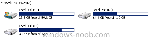

  5. How much space is enough space? Isn't there a setting which configures the amount of usable or free space on a disk?

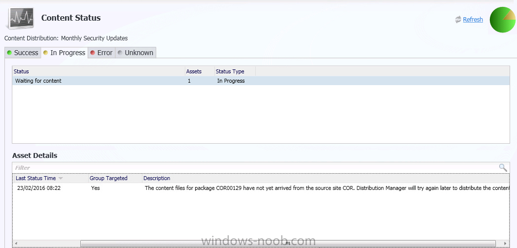

  10. Hi Apexes, I followed your instructions at 08:10 this morning and waited until 09:08 when I re-distributed the content. Ive left it all day and its still showing the message "The content files for COR00129 have not yet arrived from the source site COR.

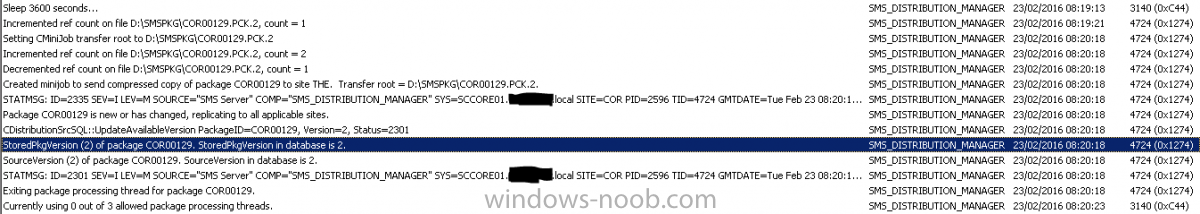

  16. Hi Apexes, Yes I can get other content onto this DP, only yesterday I distributed new win 10 boot images successfully. None of the logs help me. I can see the sender.log says "Finished sending SWD package COR00129 version 2 to site THE" but that was on the 23/02/2016 at 08:22am no mention of that package since. Pkgxfermgr.log just shows multiple waiting for new/rescheduled send requests. Distmgr.log has this as its last entry relating to this package "Exiting package processing thread for package COR00129." on the 23/02/2016 at 08:20am I've attached below. Everything looks fine from the logs. PkgXferMgr.log sender.log distmgr.log

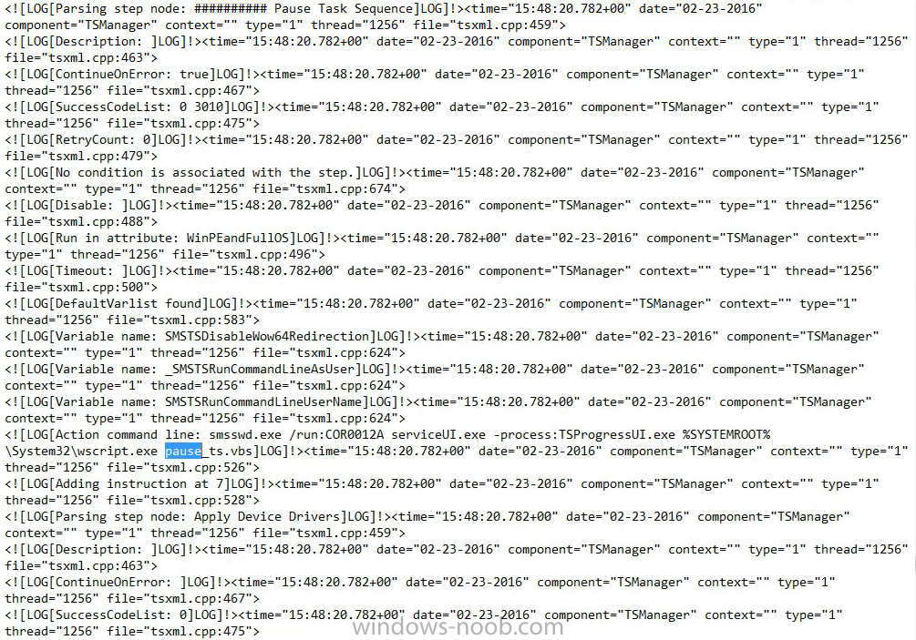

  17. But heres the error from the log I saw. ![LOG[Failed to execute command line 'C_SMSTaskSequencePackagesCOR0012AserviceUI.exe -processTSProgressUI.exe XWINDOWSSystem32wscript.exe pause_ts.vbs' . This version of is not compatible with the version of Windows you're running. Check your computer's system information and then contact the software publisher. (Error 800700D8; Source Windows)]LOG]!time=085230.146+00 date=02-24-2016 component=InstallSoftware context= type=3 thread=1176 file=runcommandline.cpp562
  18. Is it the 401 - Unsuccessful with anonymous credentials error? It is shortly followed by an attempt to use the context credentials. 401 - Unsuccessful with context credentials error?
  19. Ive attached the file here. smsts_win10_PauseFailed.txt
  20. Hi, I think it was giving the error and crashing out because I didnt have "Continue on error" ticked. Now it just flashes up the title and skips past without stopping or display the window.
  21. Hi, ADK 8.1 Build 8.100.26866 WinPE 6.3.9600.16384 is the boot image version. ConfigMgr I think its 5. Vince
  22. Hi Anyweb, I tried this in my windows 10 TS and it throws this error. Failed to run the action ###########Pause Task Sequence. This version is not compatible with the version of windows your running. Check your computer's system information and then contact the software publisher. (Error: 800700D8; source: Windows) Im using the serviceUI.exe from the MDT2012 Update 1 you linked above. Im using a 64 bit boot image and the 64bit version of the serviceui.exe file. Any idea why this isnt working? Regards Vince
  23. A couple more screen shots. These are the drives on the DP that is failing. This shows the size of the package from the Content view under Monitor.
