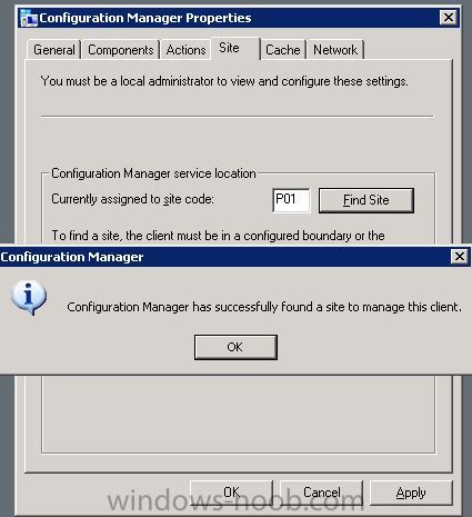

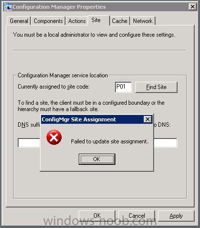

Configuration Manager in Control Panel is blank
Kazi replied to Kazi's topic in Configuration Manager 2012
Thanks for the reply Garth. Yes, I checked that as well - and the Default Namespace is root\cimv2. That's why I have been pulling my hair out... I obviously MUST be missing something, yet I feel that I tried everything. When I go into the Configuration Manager in the Control Panel, like I said before, all tabs are blank. If I go to the site tab and click on Find Site, it successfully finds the site code without me having to enter it, but when I click APPLY, I get an error that ConfigMgr cannot update the site. See below: -
