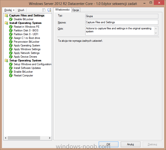

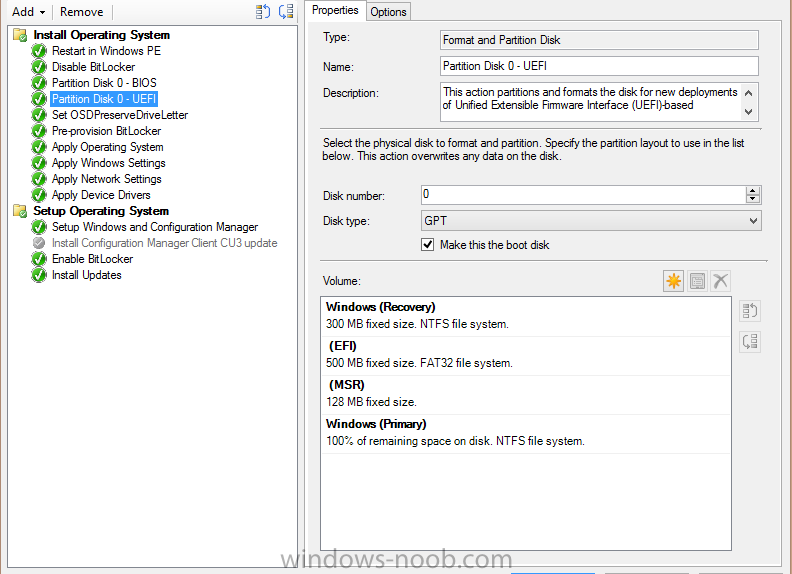

Hi, I have a problem with Windows (and Hyper-V) Server 2012 R2 OSD task sequence - the OS fails to boot after the "Install Operating System" group is done, and computer is rebooted - I'm getting error 0xc0000001. I've found out that bitlocker is the issue here - if I disable TPM on the machines I've got problem with it runs without any issue. Strange thing is - same TS works for Windows 8.1 Enterprise x64 (only thing I changed for that TS is porduct key, System OU, and of course system image). Any ideas why that might be?

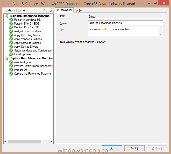

Build and capture did not work for me for Windows 2008 at all (I've never seen any error message, it does the build, but not capture). Here are my (very basic) task sequences for B&C and standard install (probably only customized thing in both is OS image (version is 6.0.6001.18000, chosen edition is SERVERDATACENTERCORE).

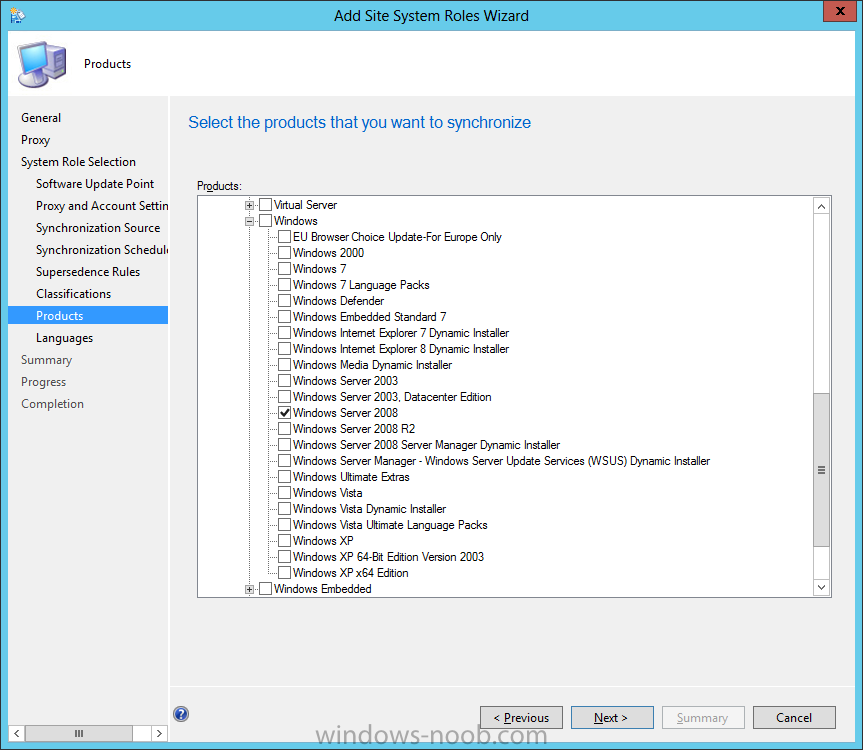

Hi, I've set up WSUS on WIndows server 2012 on the same system, where most of of my SCCM (2012 SP1 CU2) site roles are residing. Standalone WSUS, offers products such as Windows 8/8.1/2012/2012R2, but when I want to setup Software Update point SCCM role, newest windows products, that are offered are Windows 7/2008R2. What do I need to fix, to be able to offer Windows 8/2012+ updates to my clients from SUP?
