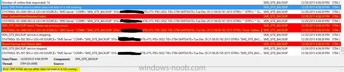

Called Microsoft Support and was able to assist with this issue. My main problem was the smsbkup.ctl file was missing from the inboxes\smsbkup.box. -
Hi All, I am trying to perform a site backup using ConfigMGR Service but failing. The SMS_Site_VSS_Writer, SMS_SITE_BACKUP, and Volume Shadow Copy service are unable to remain on. Every time I manually run each service, they turn on and 5 seconds later turns off. I looked into the smsbkup.log file and it is indicating that the "SMS Writer service either does not exist or is not running." Has anyone else experienced this issue or have any insight as to how to resolve it or can point me to the right direction?

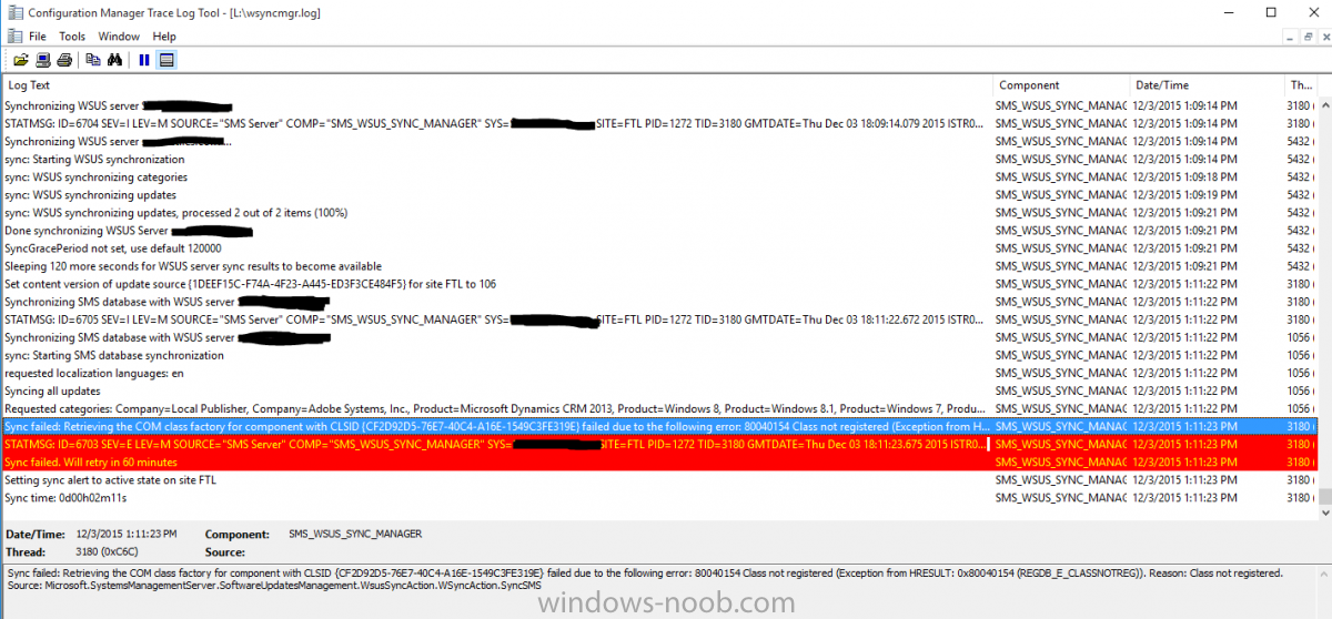

Hi, I have been trying to re-sync my SUP but have been unsuccessful. Thus far I have removed the SUP from SCCM, rebooted, removed the WSUS and IIS role, rebooted, added the WSUS and IIS role, rebooted, added the SUP in SCCM with ports 8530 and 8531. So far no avail. Below I have provided a screenshot of the sync error within my wsyncmgr.log file which looks like its pointing to .DLL file that is not being registered. I dug a bit and found the SUPSetup.log and the wsusmsp.dll is being registered. So I did some searching in the registry files and could not find the CLSID class entry the below log is looking for. Not sure if I am doing something but any suggestion would be greatly appreciated. -

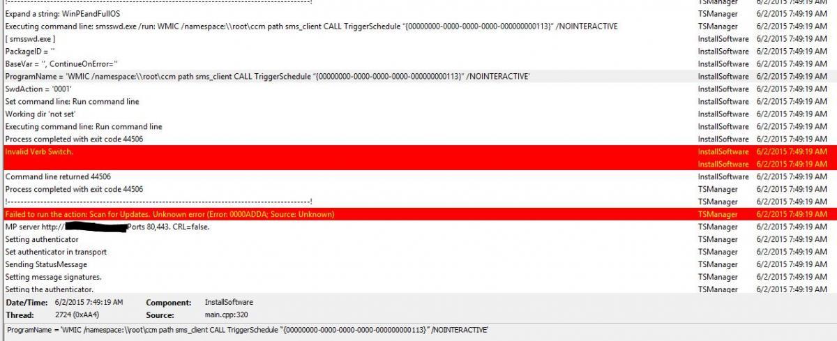

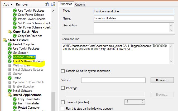

Hi all, I am having a very difficult time to setup a Software Update TS to actually install all available updates during OSD process. I have notice that it sometimes work but most of the time it does not install updates and TS just continues the rest of the process. I have looked online for ways to apply all updates and found the below cmd to add during my TS to scan for updates. However, I keep receiving the below error message when running this cmd. Any ideas as to why I am receiving the "Invalid Verb Switch" when running this cmd? I receive the same error message when I try to run it locally on the imaged PC. Also I have my Software Update Group deployed to "All Unknown Computers" collection; not sure if I have to deploy it to another collection to be available to known PCs that I want to re-image. Is this is not an ideal solution than can anyone advise what would be the best solution to apply software updates during OSD? I know about the offline service feature with the image but I would really like to know how to apply updates during OSD. I have also attached a screenshot of my TS. WMIC /namespace:\\root\ccm path sms_client CALL TriggerSchedule “{00000000-0000-0000-0000-000000000113}” /NOINTERACTIVE

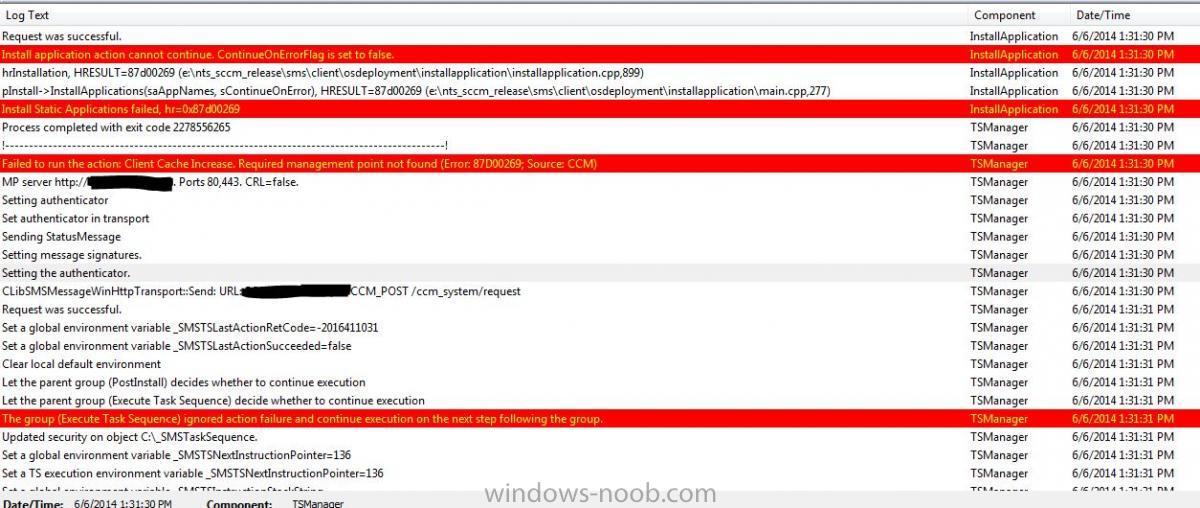

Thanks Jorgen, the netsetup.log indicated that the issue I was experiencing was that I was selecting 'Computer' AD group, during the OSD, to place my PC in but this process is not possible. It was telling me that the OU does not exist since Computer is not an OU. Once I selected a different OU, the computer was joined and all the applications were installed, thanks Peter and Jorgen. Is there a way to select the Computers "OU" to add newly joined PCs during the OSD process? Not sure if leaving a selecting in the UDI Wizard blank will it know to join it to the default Computer "OU" -

Thanks Peter I will attempt this today. However, I also notice that the PC does not get joined to the domain when it reboots into Windows. So not sure if this variable will assist me with that issue? Also where in my TS should I place this variable? -

It did restart during the 'Setup Windows and ConfigMgr' step but then continues the same step after the restart. And yes, all of the X1 carbons here have SSD drives; including the new X1 carbon. -
Hi, I keep receiving the below error message during OSD when it hits the Install application step. We just received the new X1 Carbon laptops and have imported the NIC drivers from Lenovo's website. Earlier model of the X1 Carbon are able to successfully image without any errors. Not sure if this is related to the NIC drivers or any other drivers that I imported for this model. It says it can't find the Management Point but it clearly indicates the management point site below the error message. So im not sure why it can't find it when every other PC here can detect it and complete the installation. I've tried manually inputting the MP in the Setup Config Mgr step but the PC does not get added to the domain. Has anyone else here encountered this issue before? Any suggestion or assistance would be greatly appreciated it.
