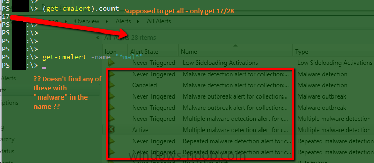

I could find approximately nothing with Google, other than the standard documentation, which is either wrong, or I'm completely misunderstanding. From its own help: SYNOPSIS Gets Configuration Manager alerts. Example 1: Get all alerts PS C:\> Get-CMAlert Except it doesn't. It misses a ton of them. On our new 1606 site, it returns only 17 of 28 alerts, and none of the ones I'm actually interested in (SCEP alerts). In another forest with 2012 R2 + CU3, it returns 186 of 192. Better, but still not all. Are certain things, e.g. SCEP alerts, not considered "Configuration Manager alerts" or something, even though they show up in Config Manager's alerts workspace? If that's the case, anyone know how to determine what type of alerts those are, and how to interact with them?

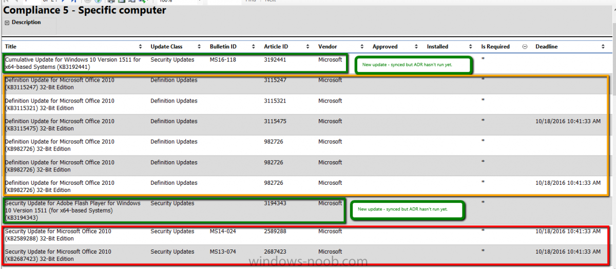

Anyone seen this? It only appears to be affecting Office 2010. Updates, generally older ones, that meet the criteria for installation - Office 2010, not superseded, Security or Definition Update categories. They're not getting installed. A report run against a computer that shows as needing them comes back with some updates only marked Required, while others are marked Required and have a deadline, but none of them show as being approved. How can an unapproved update get deadlined, and if it meets the criteria, why isn't it approved? Blowing up all Office 2010 update groups and creating a new single update group for Office 2010 via a manually run, unscheduled ADR didn't help, just put today's date on the offending updates. Also confused as to why multiple old definition updates show up more than once (KB982726 from Sept 2014) and don't show as superseded (e.g. by KB3115475 from August 2016) , even though they're for the same thing (Outlook 2010 Junk Email Filter), albeit with different KB numbers.

I actually ran into something similar earlier this week. Are you sure they're not already in process, and just waiting on a reboot? For my case, it was a matter of a pending reboot. Updates targeted to machines had the reboot suppressed. They had run through installation, and were waiting for users to reboot. SCCM reporting, at that point, showed them as not required. Once these systems were rebooted, the updates started showing as installed.
