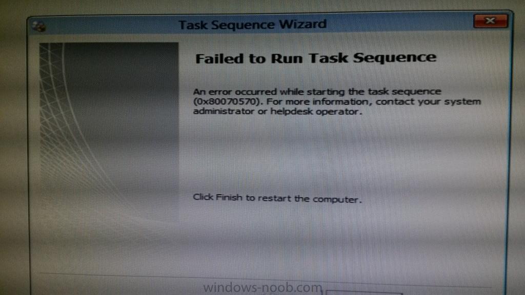

  4. There is more complexity to this issue. We had an issue with the distribution point that was located on our secondary site server, PXE boot stopped working, and the DP had become corrupted, so I had to re-create the distribution point. I distributed an operating system image, basic Windows 7 w SP1, across to this newly created distribution point, but we are still getting a similar error message when trying to deploy images: Failed to Run Task Sequence - an error occurred while starting the task sequence (0x80070570). 0x80070570 error relates to "the file or directory is corrupted and unreadable" I am thinking that maybe the secondary site server has some corruption on the some of the files/folders. Do you think it would be worthwhile re-installing SCCM 2012 onto the secondary site server for a clean start? If so, can you please provide doco on re-installing SCCM 2012 onto a secondary site server?
  5. Please close this ticket. The distribution point was corrupt so needed to be re-created. Thanks for your help.

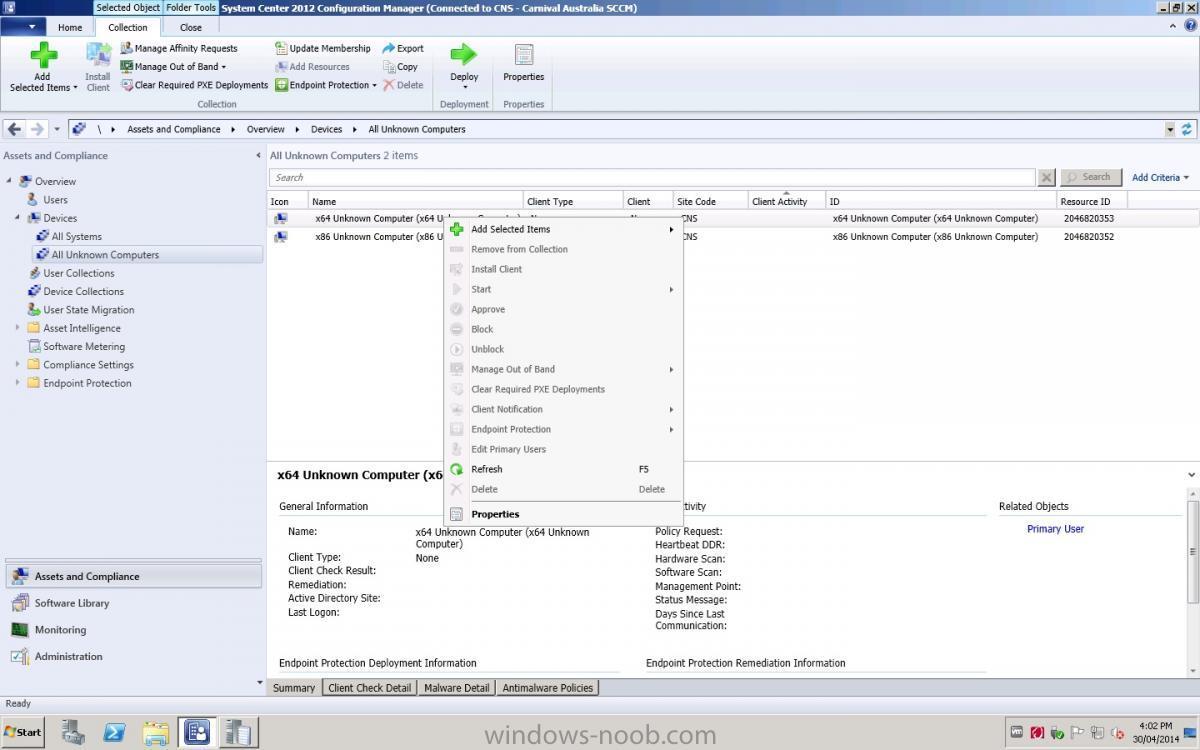

  6. I right-clicked on the collection, All Unknown Computers, selected "Clear Required PXE Deployments", waited a few minutes, but the same error is occurring. I also tried the same thing again, and then rebooted the SCCM server, but still no luck. Any ideas ???

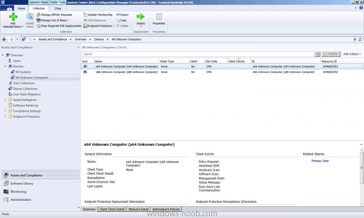

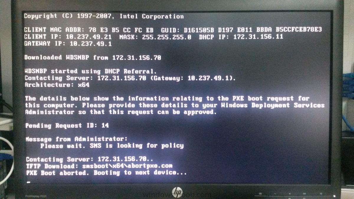

  7. Hi, I have an issue with one DP where they can't PXE boot - see attached error (TFTP Download: smsboot\x64\abortpxe.com) They have tried old and new laptops, and desktops with 2 different task sequences but the same error message appears. I checked the SMSPXE log (see attached) and was trying to delete an unknown computer with Resource ID 2046820353, but I am unable to delete it - see attached image. Can someone please advise the steps I need to take to get PXE boot working again (it was working just over a week ago). Also, I have 2 other DP's and PXE boot is working fine at these ones. Thanks. SMSPXE.log
