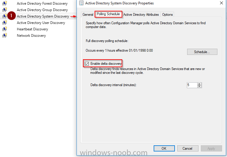

  18. I don't think you can do that ... (I'm maybe wrong) But why not enabling the delta discovery (every 5 minutes) ?
