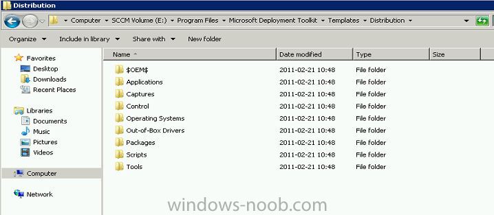

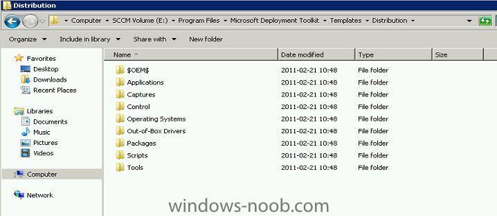

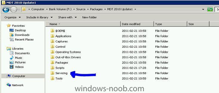

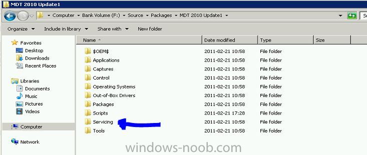

First of all I will start with a quote from Niall: "Before starting make sure you upgrade to MDT 2010 Update 1" When this is done make sure you create your MDT Package correctly.. The correct way is by letting a custom MDT task Sequence create the package for you. If you do what i did it will not work. I installed MDT 2010 Update1 to E:\Program Files\Microsoft Deployment Toolkit I then opened "E:\Program Files\Microsoft Deployment Toolkit\Templates\Distribution" and made a package of the content, because these are the MDT script i need right? Doing it this way will work until you decide you want to try language packs or offline patches. Then you will start getting these messages in your ZTIpatches.log FAILURE (Err): 76:Copy Folder: C:\_SMSTaskSequence\WDPackage\Servicing\X64 toC:\_SMSTaskSequence\Servicing - Path not found ZTI ERROR -Unhandled error returned by ZTIPatches: The system cannot find the filespecified. (-2147024894 0x80070002) SMSTS.log returned this error: Failed to run the action: Install Language Packs Offline. The system cannot find the file specified. (Error: 80070002; Source: Windows) This happens because if you copy the bits from the installationdir of MDT then the servicing folder will be missing. Dont make a package of this dir: A proper MDT package: Hopefully this will help someone -

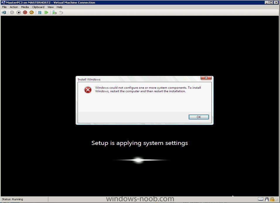

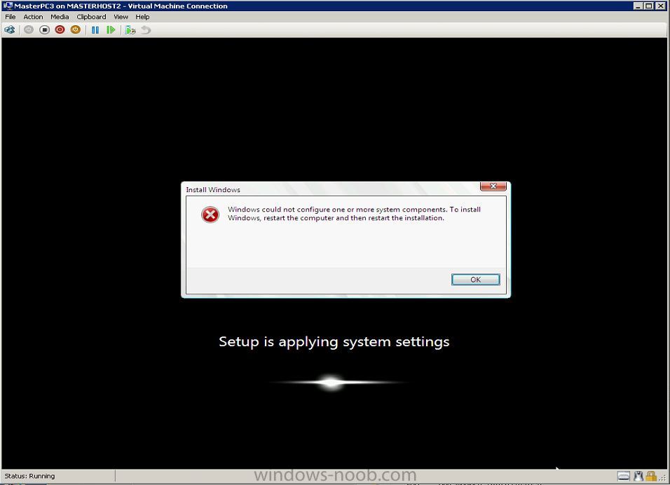

Memory issues when deploying win7 x64 with lang pack
wmmayms replied to wmmayms's question in Troubleshooting, Tools, Hints and Tips
This was done on a virtuall HyperV Guest while deploying Windows 7 Enterprise x64 with swedish language pack. If deploying Windows 7 Ultimate x86 with language pack it seems to work with 1024Mb ram though. I was lucky that i deployed two machines at the same time (one with 1024Mb and one with 2048Mb), or it would take far more time figuring out why it dident work =) -

If you get the following error message you need to look over your hardware: "Windows could not configure one or more system components. To install windows, restart the computer and then restart the installation" I noticed that I got this error message when trying to deploy windows 7 x64 with language pack, if I had less then 1280Mb ram configured. If i go with 1280Mb ram or more the installation succeeds. PS win7 will install just fine on 1024Mb ram if you dont apply any language pack.

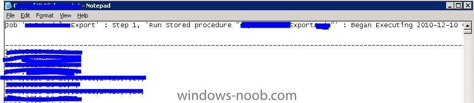

When you run scheduled jobs in MS SQL you sometimes want to output the results to a txt file. This works like a charm... However MS tends to add four annoying rows to the top of this output file. I thought it was easy to remove these rows with a simple vbs/batch command....but No!! Since it´s unicode format it gets a bit harder... here is the code i ended up using: 'Written by wmmayms 13/12 - 2010 Option Explicit strTextFile = "<----ADD PATH TO YOUR TXT FILE HERE---->" Dim objFSO, objFile , strTextFile, strData, strLine, arrLines, i CONST ForReading = 1 CONST ForWriting = 2 'Create a File System Object Set objFSO = CreateObject("Scripting.FileSystemObject") 'rename file objFSO.MoveFile strTextFile, strTextFile & "_temp" 'Open the text file with unicode format (-1) - strData now contains the whole file strData = objFSO.OpenTextFile(strTextFile & "_temp",ForReading,false,-1).ReadAll 'Split the text file into lines arrLines = Split(strData,vbCrLf) 'Create new file in unicode format Set objFile = objFSO.CreateTextFile(strTextFile, false, true) 'Loop through all values and remove rows 1-4 i=0 For Each strData In arrLines if i=0 or i=1 or i=2 or i=3 Then 'Do Nothing else objFile.WriteLine(strData) end if i=i+1 next 'Remove temp txt objFSO.DeleteFile strTextFile & "_temp", True 'Cleanup Set objFSO = Nothing Set objFile = Nothing It´s not pretty but it work =)
