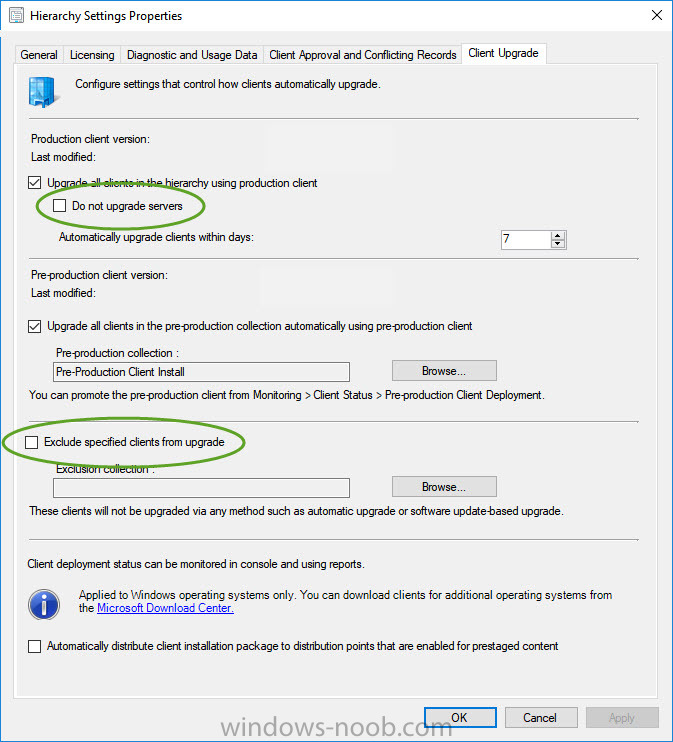

  10. What do your client upgrade settings under your hierarchy settings look like? Are the 295 non-compliant devices servers or members of a collection that is excluded from the client auto upgrade?
