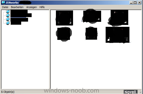

Hello Everybody, currently we use ZenWorks in our environment. I was able to deploy PDF files to the ZENworks console. The PDF files are displayed in the console and when I open them, an Explorer with the PDF opens it. If you look at the Explorer path, you can see that the PDF document is retrieved from a server. Goes something like this in SCCM 2012R2? Here is a picture. On the left side are the different locations like LA, San Francisco and so on. On the right side, i can see the pdf-files on each location. I need something like this in SCCM. I cannot work with GPO.
