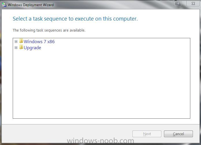

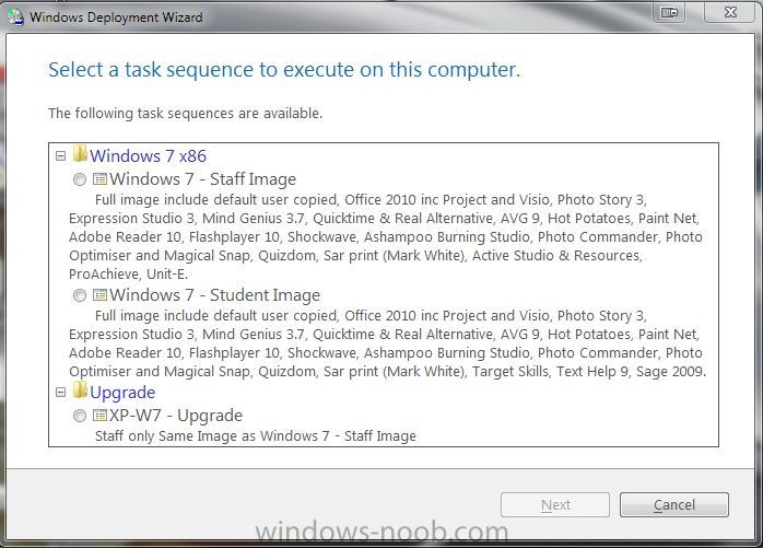

  15. Hi another question about MDT 2010, How do you make the following window that appears in the Windows Deployment Wizard appear so that rather than have this-see image attached WDW-1 as the default. I would rather it was this-see image WDW-2
