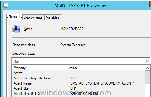

  3. It is enabled the AD discovery method and selected for the creation of boudauries automatically by AD sites. As imagagem the discovery shows which site (boudaurie) the machine belongs. As I said secudnários are two servers with different ... and even Symptom. Only running the main site.

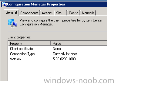

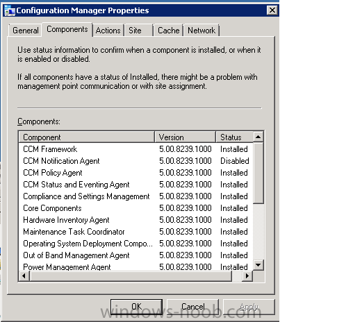

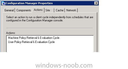

  4. Good afternoon, I can not install the client on two secondary sites. My account structure by enquando with a primary site and two secondary. Attached the log and client control panel images. Install a part, but not complete. I appreciate the help in advance. ccmsetup.log
