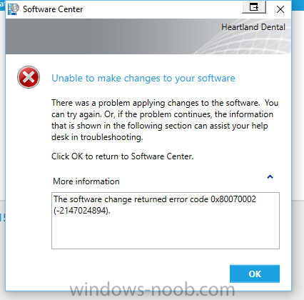

  15. Great guide! I hope you can offer some help though. I was able to follow these steps and upgrade two test VM's I setup with 1507 and 1511 to 1607 no problem. I added two production computers to the same collection as the test VM's, but they will not upgrade. They receive the advertisement and download the upgrade but fail installation. The error message is "The software change returned error code 0x80070002 (-2147024894)." I've researched this to learn that the file is not found but when I look in the ccmcache folder, it's there. I've checked UpdatesHandler.log and UpdatesDeployment.log but nothing pops out to me. Any idea why this is happening?
