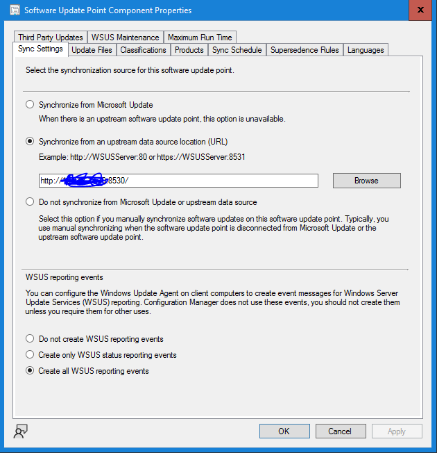

Okay - now a new issue. Why is this so frustrating to get working. New WSUS server is working, updates are synchronizing, 8530, 8531 inbound traffic allowed. On my MECM server, I have the WSUS console installed, per the message on the SUP properties page. Using the WSUS console, I can connect to remote WSUS server. I have the SUP configured on my Primary Site Server and have the synchronize from an update data source specified to the remote WSUS server. Additionally, I went ahead and deleted the SUSDB from the SQL Server running on the primary site server. When I attempt synchronization, the following errors appear in the logs (wsyncmgr and wcm) What am I missing, or where else can I look.
That I did not do. I got so frustrated that I just setup a separate WSUS server with its own separate SQL instance instead of it being on the MECM server. I haven't tested the connection yet to synchronize from the upstream server as I am just waiting for the synchronization of the WSUS server I setup to complete.

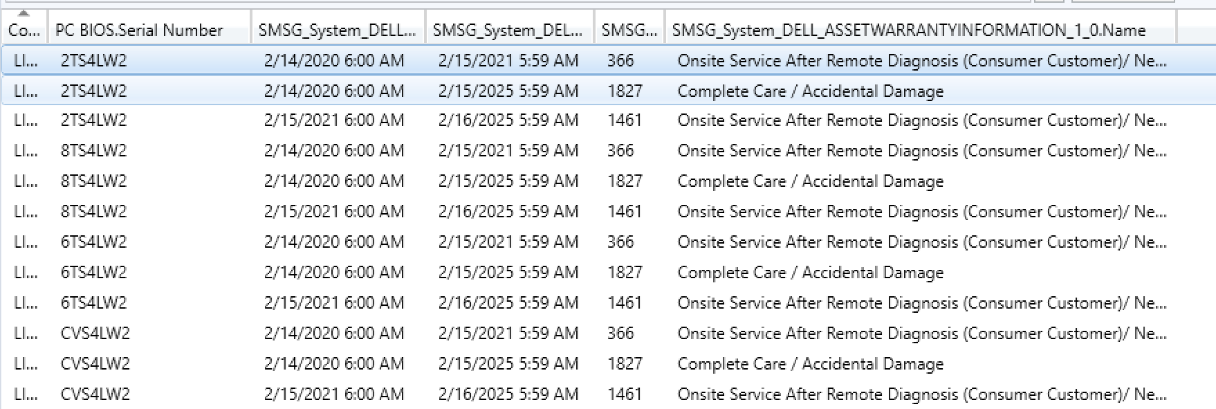

Thanks Garth for pointing me in the right direction! I now have a properly working report using the following query that gives me everything I need. SELECT v_GS_COMPUTER_SYSTEM.Name0 as "Computer Name" ,IdentifyingNumber0 ,[WarrantyStartDate0] ,[WarrantyEndDate0] ,[WarrantyDuration0] ,v_GS_DELL_ASSETWARRANTYINFORMATION0.Name0 FROM [CM_LIB].[dbo].[v_GS_DELL_ASSETWARRANTYINFORMATION0] join v_GS_COMPUTER_SYSTEM on v_GS_COMPUTER_SYSTEM.ResourceID = v_GS_DELL_ASSETWARRANTYINFORMATION0.ResourceID
Hi all, I am using the Dell Command Monitor system to gather warranty dates, etc. for all my Dell brand systems. I have a working query, but however the data is gathered, the Dell clients have "extra / duplicate (not exactly)" information that I cannot figure out how to filter out. Additionally, I am trying to take the query and create a report from it so I can export the information. Here's the query: select distinct SMS_G_System_COMPUTER_SYSTEM.Name, SMS_G_System_PC_BIOS.SerialNumber, SMS_G_System_DELL_ASSETWARRANTYINFORMATION_1_0.WarrantyStartDate, SMS_G_System_DELL_ASSETWARRANTYINFORMATION_1_0.WarrantyEndDate, SMS_G_System_DELL_ASSETWARRANTYINFORMATION_1_0.WarrantyDuration, SMS_G_System_DELL_ASSETWARRANTYINFORMATION_1_0.Name from SMS_R_System inner join SMS_G_System_DELL_ASSETWARRANTYINFORMATION_1_0 on SMS_G_System_DELL_ASSETWARRANTYINFORMATION_1_0.ResourceID = SMS_R_System.ResourceId inner join SMS_G_System_COMPUTER_SYSTEM on SMS_G_System_COMPUTER_SYSTEM.ResourceID = SMS_R_System.ResourceId inner join SMS_G_System_PC_BIOS on SMS_G_System_PC_BIOS.ResourceID = SMS_R_System.ResourceId Here's the results - as you can see from the screenshot, there are multiple entries for the same system. I have worked through this somewhat and can reduce the output to only show those with "Complete Care / Accidental Damage" however, that term wasn't always used by Dell, and some of the computers that are under warranty but don't have the same coverage. This removes the "duplicate" data. where SMS_G_System_DELL_ASSETWARRANTYINFORMATION_1_0.Name = "Complete Care / Accidental Damage" Lastly, I built a report using Report Builder, that has the following query - which works through Query Designer (in report builder), but when I try to run the report, I am met with an error. SELECT Name0 ,[IdentifyingNumber00] ,[Name00] ,[WarrantyStartDate00] ,[WarrantyEndDate00] ,[WarrantyDuration00] FROM [CM_LIB].[dbo].[DELL_ASSETWARRANTYINFORMATION_DATA] join dbo.vSMS_R_System on DELL_ASSETWARRANTYINFORMATION_DATA.MachineID = dbo.vSMS_R_System.ItemKey WHERE Name00 = 'Complete Care / Accidental Damage' Error (I have checked through SQL Management Studio and the user account I ran the query as in the designer has the correct permission): The SELECT permission was denied on the object 'vSMS_R_System', database 'CM_LIB', schema 'dbo'. ---------------------------- Query execution failed for dataset 'DataSet1'. (rsErrorExecutingCommand) ---------------------------- An error has occurred during report processing. (rsProcessingAborted) Any help is appreciated, Jesse

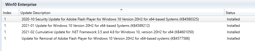

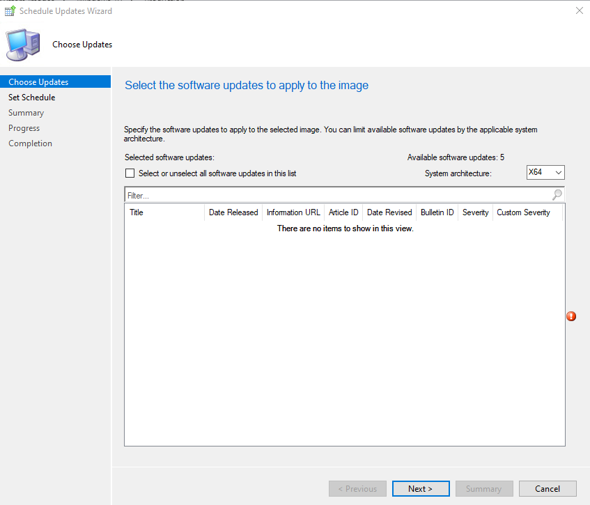

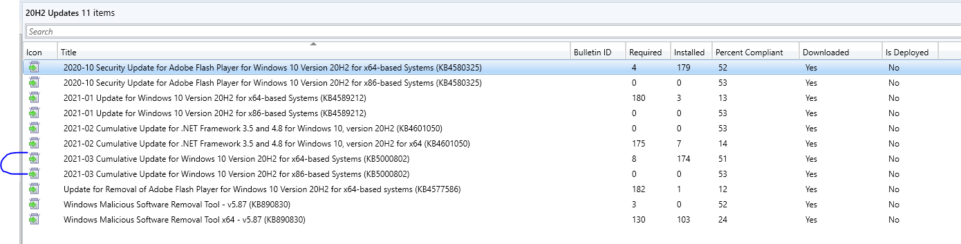

I have downloaded the most recent software updates for Windows 10 20H2 x64, as can be seen in this image: I went ahead and redistributed the deployment package, to make sure the latest updates added were available. Then, I clicked over to my operating system image. right clicked, and chose Schedule Updates. Those two updates will not show as available as can be seen in this image (additionally, the Windows Malicious Software Remove Tool or update doesn't show as available either): So, to make sure that they aren't already applied, I clicked the update tab on my OS image. Any ideas? Once the image is applied, if I go to check Windows updates, the missing ones download and install. Thanks, Jesse
