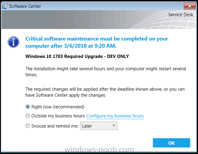

  13. Hi again I have one small issue, when I deploy the script [all configured as per instructions], first I get standard Software Center popup, instead of the hta. The below screen shows the timing to be next available deployment occurrence, for testing purposes I have 9:20 AM daily. Once I click OK on the below, only then the hta windows is brought with all the user information and deferrals count. Am I missing something maybe?
