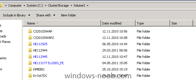

Hi, My Hyper-V Cluster with 3 Nodes is managed by SCVMM. Two cluster shared volumes are available for the deployment. When I want to deploy a machine to the cluster shared volume2 following error appears: 'TemplateTest': Cannot open attachment 'C:\ClusterStorage\Volume3\TemplateTest\Server 2003 R2 Enterprise 64Bit NOT SYSPREP_disk_1.vhd'. Error: 'The requested operation could not be completed due to a virtual disk system limitation. Virtual disks are only supported on NTFS volumes and must be both uncompressed and unencrypted.' (0xC03A001A). (Virtual machine ID 88534423-1B24-43E6-AB6A-AA6B76871447) It seems that the volume ist "compressd" but in the properties of the volume compression is unchecked (on all three nodes). New virtual machines are marked blue. See attachment

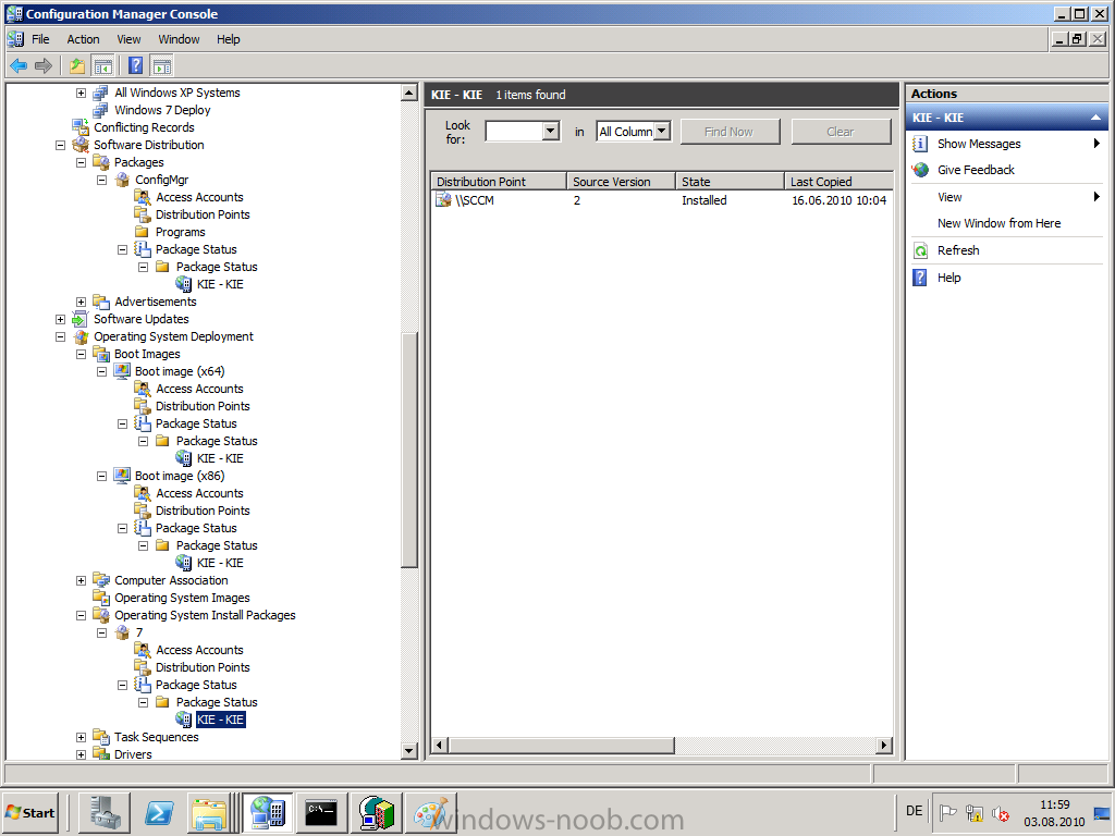

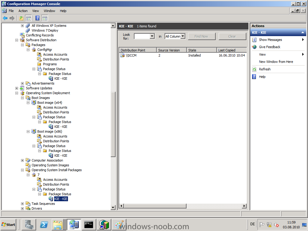

Thank you for your reply. Where can i look up if the package is on my harddrive? SCCM says that every package is "installed". I have attached a screenshot of the packages in SCCM. Edit: You are rigth i haven't added the NAA...the NAA must be the network administrator account right ?
