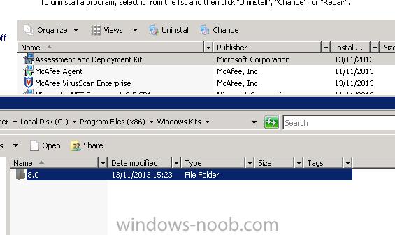

  3. It's coming up as 8.0 even though I downloaded 8.1 according to MS website download page (http://www.microsoft.com/en-gb/download/details.aspx?id=39982). Is there any where I can download another version from? This is strange! Thanks for your help

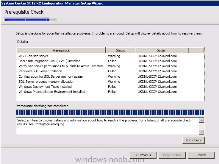

  4. Hi I have issue installing SCCM12 with this error WADT Failed, even after installing All preq (Tried installing on C and E Partition - Windows Assessment and Deployment Kit (Windows ADK) for Windows 8.1) with no diff.
  5. I have reinstalled the SQL with CP1_CI_AS but still getting error failed with USMT, Windows deployment Tools and Preinstallation even after installing and re-installed - adksetup - Windows Assessment and Deployment Kit (Windows ADK) for Windows 8.1. Is there anything I have to do or any configuration after installing this? Please help Rgds,
  6. I have Installed Assessment and Deployment tools, Windows deployment tools and WSUS but still getting this same error, also can anyone please help with how I can include SQL_Latin1_General_CP1_CI_AS after SQL installed

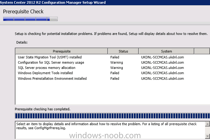

  7. I have been able to overcome this issue and proceed to prereq. check and here we go it faile with some pre-installed soft/module. I was following the installation doc on the site but not mentioning any of this. Thanks and also see screen shot attached
