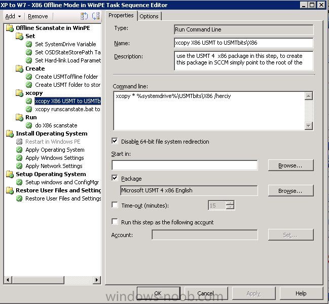

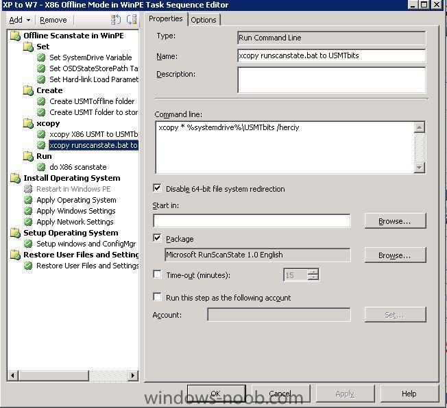

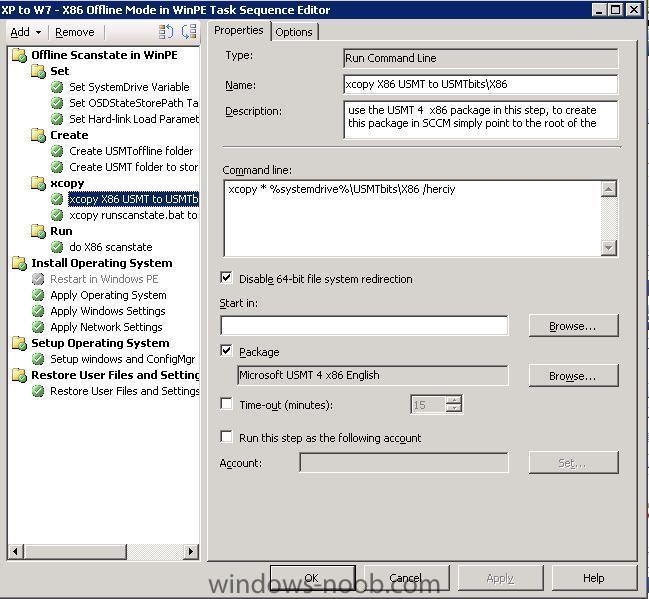

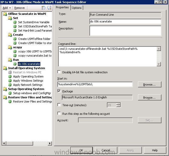

  8. Hi Peter, thanks for the reply, but sorry for the delay in getting back to you...I was out of town all last week. I've attached some screen shots to see what is typed in...I'm not seeing anything odd and the batch file, I just copy/pasted it...here it is: @set USMT_WORKING_DIR=%~2%\USMTbits\x86 "%~2\USMTbits\x86\scanstate.exe" "%~1" /c /o /hardlink /efs:hardlink /nocompress /offlinewindir:c:\windows /v:5 /l:%~2\windows\TEMP\SMSTSLog\scanstate.log /progress:%~2\windows\TEMP\SMSTSLog\scanstateprogress.log /i:%~2\USMTbits\x86\miguser.xml /i:%~2\USMTbits\x86\migapp.xml Do you see anything that I may be overlooking? Any other suggestions? Thanks again, i really appreciate it.
