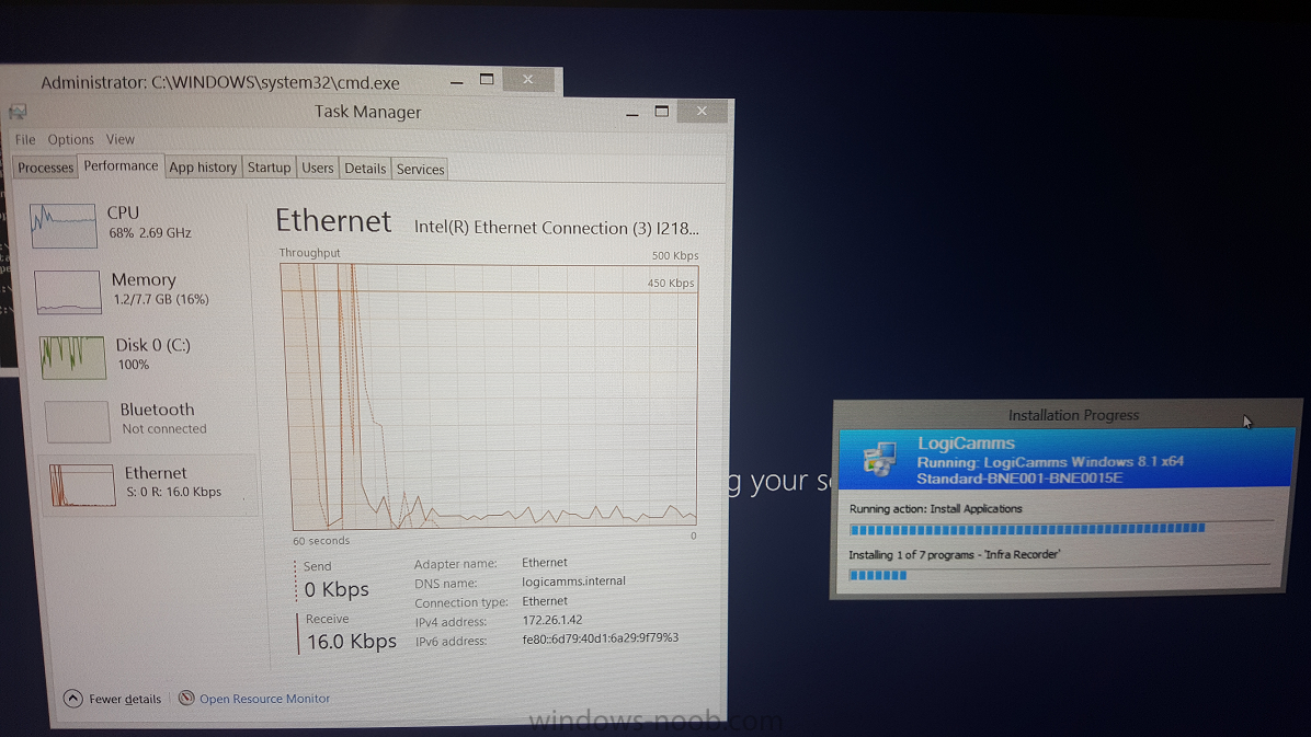

So I'm checking the network usage during the build, the big spike happens during when the client is installed, then the network seems to drop off, it makes me think the client isn't installing correctly and therefore cannot download the packages to continue with the TS, however the same TS works fine and the client installs correctly on our dell fleet. The step in the TS never actually completes successfully, it just skips it after awhile and continues to skip the remaining steps then finishes the TS.
