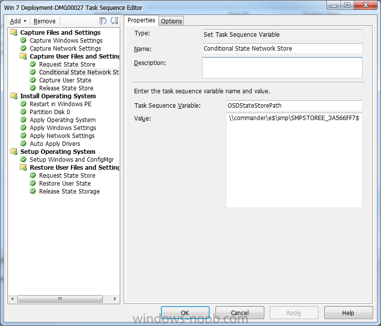

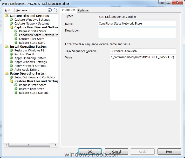

    Win 7 Deploy with an SMP
    Thanks for the reply, I have tried using the task sequence in the past without that entry and it would fail right away on the capturing user state. This is the only way I could get it to work for deploying windows 7. However today I uninstalled the SMP and re-installed it then tried again without the entry and it worked... finally!!!. So i believe my problem all along was the SMP. Thanks for your reply and please keep up the good work on helping us newbie's like me.
  4. Hi, I have a TS that deploys windows 7 to already existing windows XP boxes. I am using an SMP to hold the user state mig files. The problem I have come across is only one computer will successfully finish while the others fail at the user state capture process. What I have found in one of the scanstate logs is the error “Store path already exists Specify a different store folder, specify /o, or delete the existing store.” “A store path can't be used because it contains data that could not be overwritten.” My question is what command line can I use with the OSDStateStorePath task sequence variable that would save all userstate profiles to one location without overwriting them. Below is my task sequence; any help would be appreciated.
