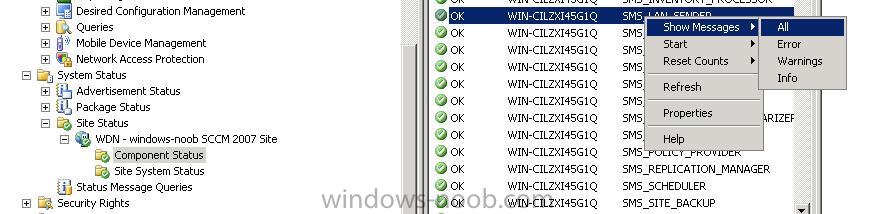

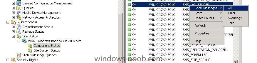

startup ConfigMgr, and go to system status,if you right click on the log you can actually read the messages to see what the errors are
have you tried that ?
you can copy/paste the errors here
