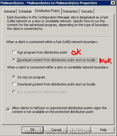

I am testing some settings with software deployments and I ran into an issue.
The software package works 100%.

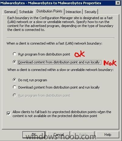

This is my setting in advertisement. (not running mandatory)
This is the error i get. Download starts and it fails at 100% with the following error.
So run program from distribution point = program will install
And download content from distribution point and run locally= error
Anyone has an idea?
