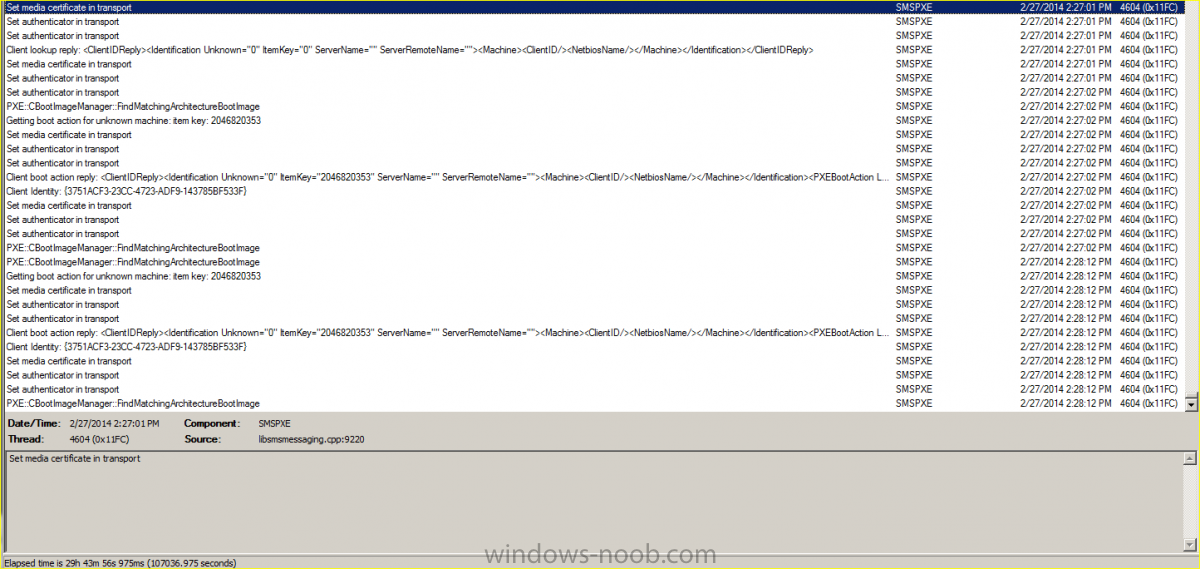

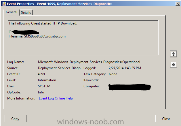

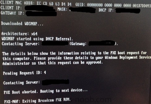

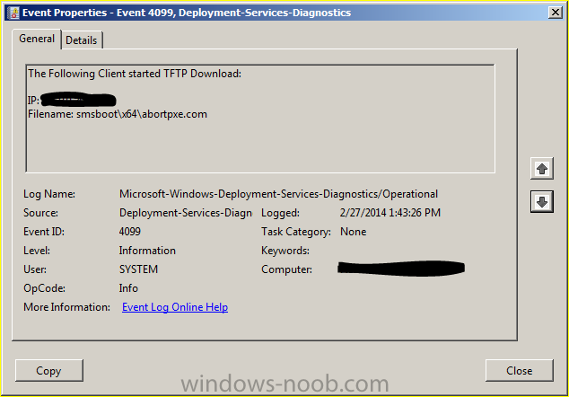

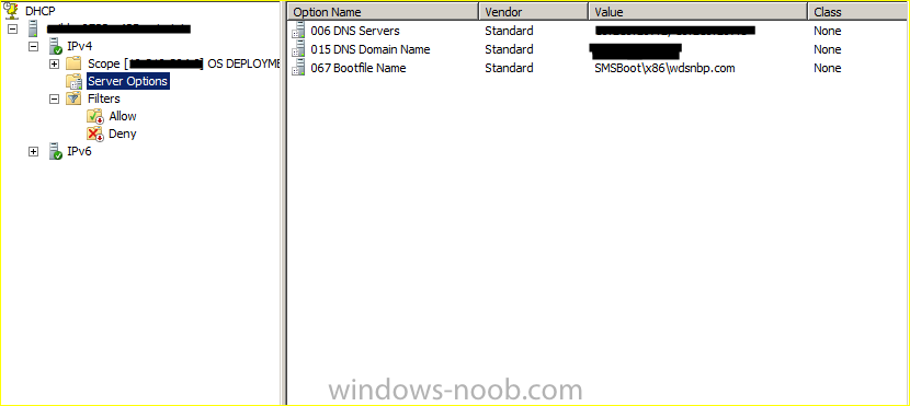

Dinus1979 Posted February 27, 2014 Report post Posted February 27, 2014 I'm really went into total confusion for this problem that seems to have no end! I followed and tried all possible solutions but I do not get out of this loop. The error is shown in the attached images. This is my work environment: SERVER 1: DHCP SERVER 2: SCCM2012 CLIENT: WINDOWS 7 I disabled the PXE on DP I have uninstalled and reinstalled WDS I recreated the boot files I enabled the reception of the client unknow I cleaned SCCM from any PC previously associated with and recognized by a query (Mac Address) I have no idea what can be HELP ME please! Thanks! Quote Share this post Link to post Share on other sites More sharing options...
