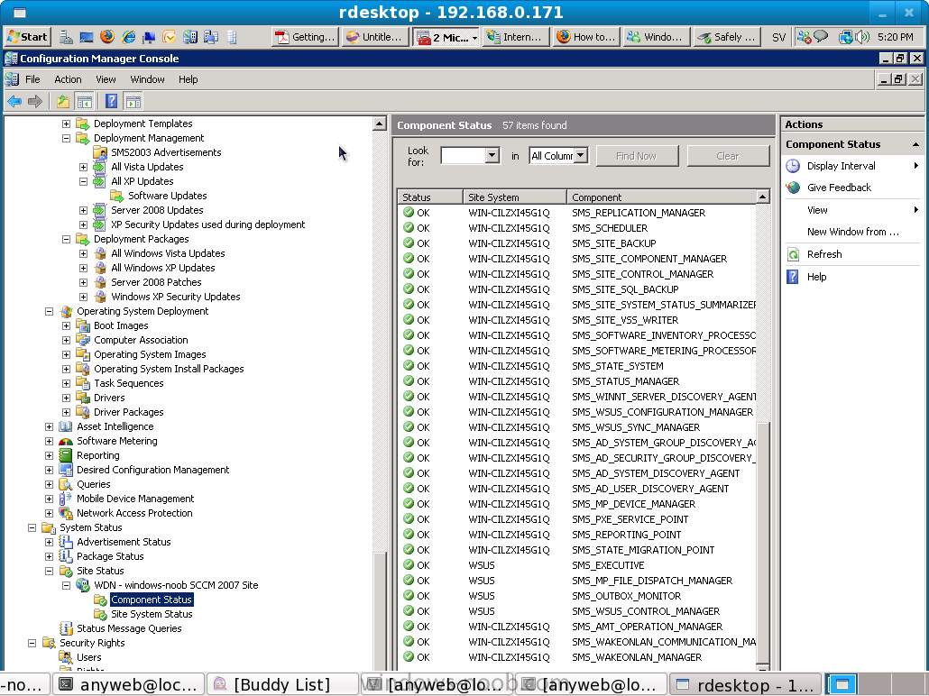

you can do software updates with wsus, or with sccm, not both, sccm will control wsus once you set it up that way,
your system status logs in ConfigMgr admin console should give you some ideas as to why its failing (look for the wsus logs)

How do I get to the status logs agin?
heres your problem
  Quote
SMS WSUS Synchronization failed. Message: WSUS server not configured.
so does the SCCM computer account have administrative priveledges on the WSUS server ?
please double check the guide.
