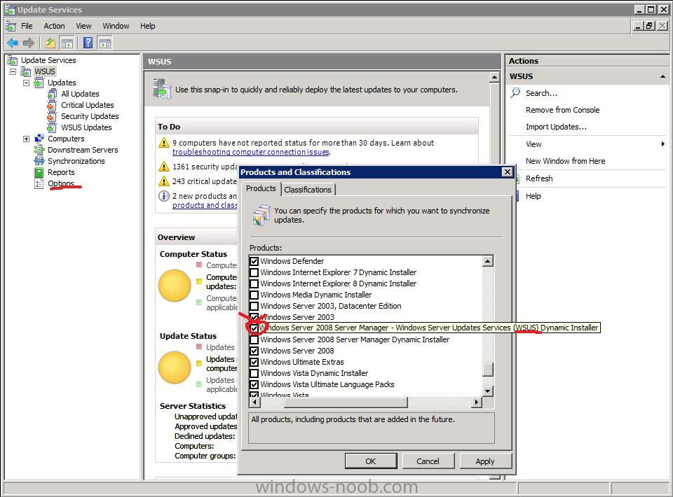

how are you instaling WSUS ? and are you referring to adding the SUP role or what ?
ok you are running windows server 2008 sp2,
please install WSUS as i have outlined in my SUP config guide by downloading the msi instead and following all the steps
I have not verifed the steps in my guide with windows 2008 sp2 yet
as a matter of interest do you have another WSUS server setup and configured already in your environment, if you do you can check the product classifcations on that wsus server and you will see the windows server ..... wsus update is listed but not checked, that 'update' needs to be downloaded before you can add the WSUS role in server 2008
look at the screenshot below
