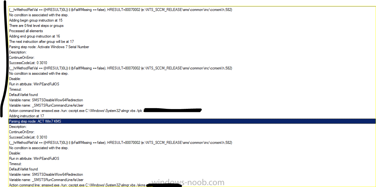

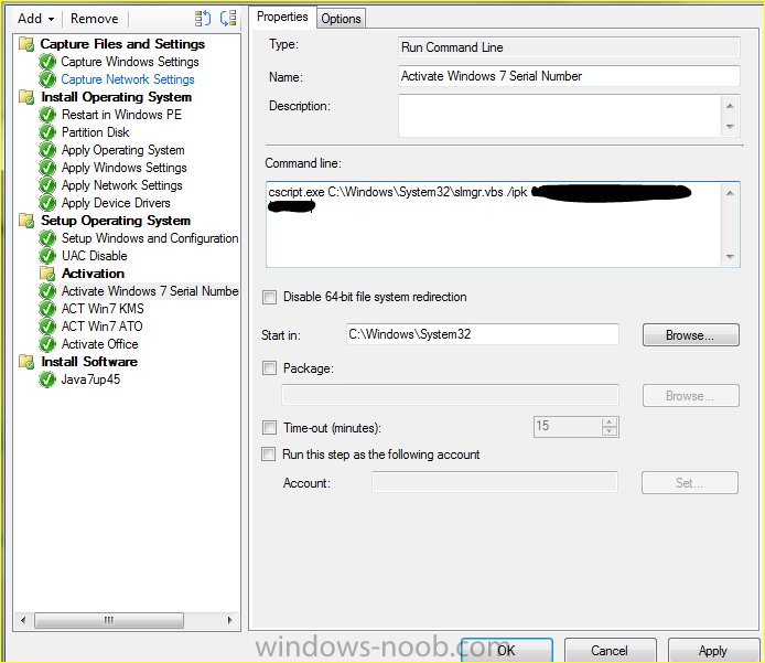

Dinus1979 Posted March 27, 2014 Report post Posted March 27, 2014 HI guys.... I created the task sequence for deploiare windows 7 sp1 ent and I entered the commands to activate the KMS server on windows of my workplace ... but all this does not work .... if you look at the log command throws without problems and without giving me errors. I am attaching pictures of everything ... I can aiutare__ Thanks Quote Share this post Link to post Share on other sites More sharing options...
Jorgen Nilsson Posted March 27, 2014 Report post Posted March 27, 2014 Hi, When using KMS you should not enter a Product key at all, the client will activate itself as well automatically when installed, you can activate it using the KMS server using the command described here:http://technet.microsoft.com/en-us/library/ff793406.aspx The KMS server key on the volume licensing site is to be used when installing the KMS server.. Regards,Jörgen Quote Share this post Link to post Share on other sites More sharing options...
Dinus1979 Posted March 27, 2014 Report post Posted March 27, 2014 Hi, When using KMS you should not enter a Product key at all, the client will activate itself as well automatically when installed, you can activate it using the KMS server using the command described here:http://technet.microsoft.com/en-us/library/ff793406.aspx The KMS server key on the volume licensing site is to be used when installing the KMS server.. Regards, Jörgen Hi Jörgen thanks for the reply ... so you do not have to enter the serial number but only the command register to kms: cscript.exe C: \ Windows \ System32 \ slmgr.vbs / skms servername.fqdn thanks Quote Share this post Link to post Share on other sites More sharing options...
Jorgen Nilsson Posted March 27, 2014 Report post Posted March 27, 2014 Hi, that is correct, the client will actually auto activate if the client can find the KMS server in the DNS as well so you should not have to do anything at all. Regards,Jörgen Quote Share this post Link to post Share on other sites More sharing options...

kevlar01 Posted March 27, 2014 Report post Posted March 27, 2014 try to add a 'Run Commandline' step. Enter the following in the commandline box: cmd /c slmgr /ato Quote Share this post Link to post Share on other sites More sharing options...
Dinus1979 Posted March 27, 2014 Report post Posted March 27, 2014 try to add a 'Run Commandline' step. Enter the following in the commandline box: cmd /c slmgr /ato ....I did not understand ... cmd /c cscript.exe C: \ Windows \ System32 \ slmgr.vbs / skms servername.fqdn Quote Share this post Link to post Share on other sites More sharing options...
alewoodrum Posted March 27, 2014 Report post Posted March 27, 2014 I deploy windows 7 sp1 and windows 8, as Jorgen said, you don't need to put a key for the operating system, by default if is doesn't have a key, the KMS server will activate it. However you could put the default KMS client key on your Task sequence, on windows settings: Operating system edition KMS Client Setup Key Windows 7 Professional FJ82H-XT6CR-J8D7P-XQJJ2-GPDD4 Windows 7 Professional N MRPKT-YTG23-K7D7T-X2JMM-QY7MG Windows 7 Professional E W82YF-2Q76Y-63HXB-FGJG9-GF7QX Windows 7 Enterprise 33PXH-7Y6KF-2VJC9-XBBR8-HVTHH Windows 7 Enterprise N YDRBP-3D83W-TY26F-D46B2-XCKRJ Windows 7 Enterprise E C29WB-22CC8-VJ326-GHFJW-H9DH4 Quote Share this post Link to post Share on other sites More sharing options...
