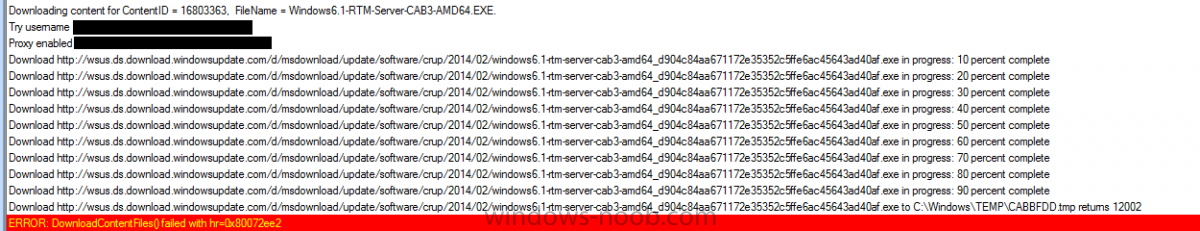

dverbern Posted April 1, 2014 Report post Posted April 1, 2014 Update - if I view the PatchDownloader.log, I can see specific updates being downloaded and then bombing out after 90%, per attached image. Quote Share this post Link to post Share on other sites More sharing options...
Ocelaris Posted April 2, 2014 Report post Posted April 2, 2014 Found this little blurb: http://social.technet.microsoft.com/Forums/en-US/5a9596d3-6f0b-4907-a788-efc06601a88a/there-was-an-error-downloading-the-software-update-12002?forum=configmanagersecurity from the post: 12002 = "timeout" and it seems like it revolves around proxy. Can you either bypass the proxy temporarily or open it up to your Computer account temporarily? Maybe check the IE Proxy settings on the SCCM Server? 1 Quote Share this post Link to post Share on other sites More sharing options...

Ocelaris Posted April 2, 2014 Report post Posted April 2, 2014 Another way you can test your proxy settings "as the computer" account is to open a command prompt (as admin), and run "psexec -i -s -d cmd" which will open a new command prompt "as the computer" then launch Internet explorer from wherever it resides in c:\program files\etc... and try to open that web page from microsoft that it's having trouble with. i.e. http://wsus.ds.download.microsoft.com----.exe and see if you can open the file. that will rule out any proxy issues (I'm assuming that this wsus download process is running as the computer account). Quote Share this post Link to post Share on other sites More sharing options...
