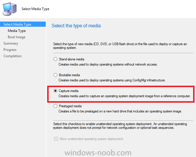

Edenost Posted April 1, 2014 Report post Posted April 1, 2014 Okay, have you created the Image Capture disc (.iso?) If you have, what you need to do is: 1. Remove the machine from the domain 2. Reboot 3. Attach the ISO to the VM 4. Wait for it to run (if it doesn't, browse to: "D:\SMS\bin\i386\TSMBAutoRun.exe", run that to start it off if it doesn't on it's own). ***Change D: to what ever drive you use, and if it's a 64 bit system, you can use the x64 directory instead of the i386 directory if you wish*** 5. Follow the wizard through, giving it a name, version, date...etc. Give it a network account which has access to the UNC (share) where you want to save it. 6. It will sysprep the machine for you (assuming all is well, you may have errors if you have messed about the standard apps like "Mail" or "People"...etc, but we can cross that bridge if you come to it) 7. It will reboot, start WINPE and take the image It will let you know when it's completed, and you should find the .WIM file located where you told SCCM to save it. You can then follow through the steps anyweb has provided to add and deploy the image to SCCM. Hope this helps. Quote Share this post Link to post Share on other sites More sharing options...

Edenost Posted April 1, 2014 Report post Posted April 1, 2014 When you create the iso, save it somewhere local on which machine you are using the sccm console. You then mount the iso which it will save in the local location you specify Quote Share this post Link to post Share on other sites More sharing options...
drewz99 Posted April 10, 2014 Report post Posted April 10, 2014 ok, now i can get to the point of selecting Distribution Point, but no distribution points show up in drop down menu? Have Boot Image selected, but I'm unable to proceed past Distribution Select? Quote Share this post Link to post Share on other sites More sharing options...
Peter van der Woude Posted April 10, 2014 Report post Posted April 10, 2014 Is the boot image available on a distribution point? Quote Share this post Link to post Share on other sites More sharing options...
