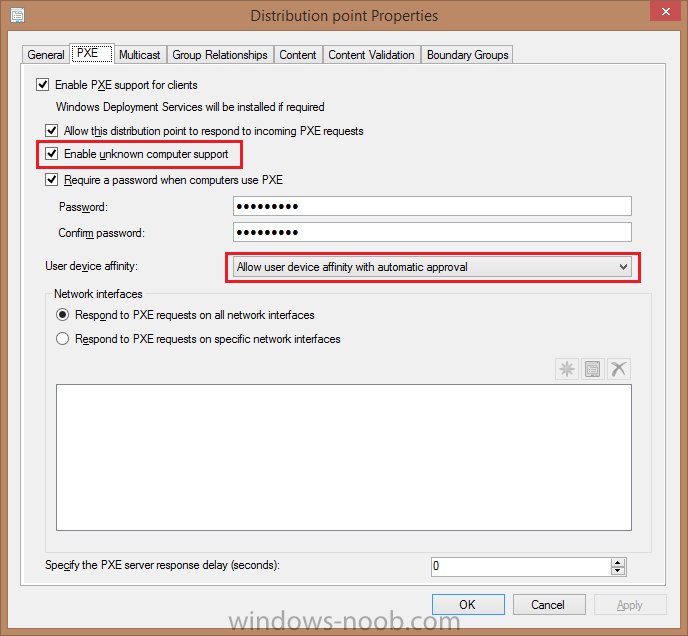

Edenost Posted April 3, 2014 Report post Posted April 3, 2014 This is set in the "Distribution Point Properties" under Site Administration\Servers and Site System Roles ? Quote Share this post Link to post Share on other sites More sharing options...
