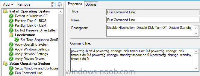

I have a task sequence that installs Windows 7 from the original .wim file and then applies a language pack and finally installs some applications and updates.
I included in the task sequence, some command line commands.
As I did not want to have to create a batch file and distribute it, I combined the multiple commands into a one-liner.
For example, changing the power options:
Essentially, the multiple commands are combined into a one-liner using the ampersand '&'
I made sure to test the command lines on a Windows machine to make sure they are valid commands - which they are.
However, the task sequence does not seem to run them at all.
I have other command lines in the same task sequence (single command) - they all run perfectly.
Why is it the one-liner multi-commands don't run? Does SCCM TS not support '&'?

Hello,
I've seen this exact same behavior during my Task Sequences with the same '&' sign in it. You could also create a package with all the commands in a .cmd/batch file. And then just run that package during your Task Sequence. I tried the exact same powercfg configurations during the Task Sequence, but it didn't work out.
You can also set Power Settings in the Device Collections, just right click on them and go to Power Managment.
