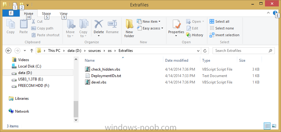

Step 1. Download the files
Download the following files
Extrafiles.zipFetching info...
and unzip to somewhere useful like D:\sources\os\extrafiles

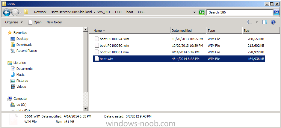

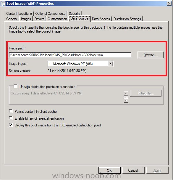

Locate the boot wim that you use most often in your task sequences in the console and identify it's path. In the example below we will edit the i386 (X86) boot wim, but you can just as easily replace the path with X64.

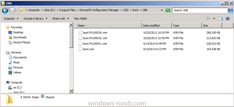

browse to the data source listed in the properties and you'll probably see a few wim files, the file we are interested in is called boot.wim as every time your boot wim file is updated (for example adding drivers), this file is used as the source for all changes.

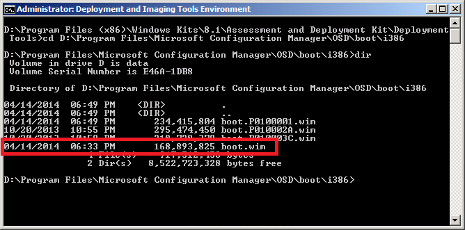

This file will be present locally on our Configuration Manager primary server in the following path D:\Program Files\Microsoft Configuration Manager\OSD\boot\i386\boot.wim assuming Configuration Manager is installed on D:\.

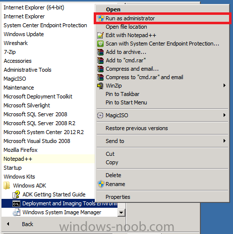

We will modify the boot wim file in the local path. To inject files we first need to mount the file with DISM. Use the version of DISM that comes with System Center 2012 R2 Configuration Manager, the correct version is included in ADK 8.1 and the correct version of DISM is 6.3.9600.16384. To start the correct version of DISM locate it in your start menu and right click on the Deployment Imaging Tools and Environment cmd prompt, choose Run as Administrator
and change directory to the directory that has your boot wim file. You can check the contents of the directory to verify that the boot wim file is present.

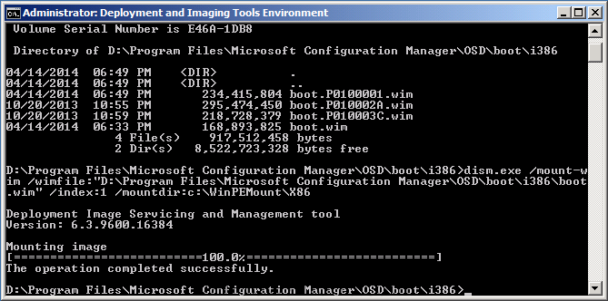

using Dism mount the image using the following command
dism.exe /mount-wim /wimfile:"D:\Program Files\Microsoft Configuration Manager\OSD\boot\i386\boot.wim" /index:1 /mountdir:c:\WinPEMount\X86
press Enter when done

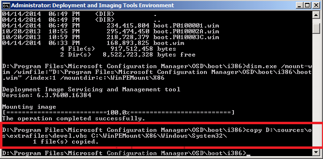

Using Explorer, or a command prompt, copy the file called devel.vbs from our downloaded files from Step 1 to C:\WinPEMount\X86\Windows\System32 for example like in the screenshot below

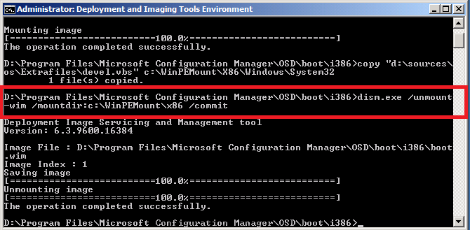

Now the file is in place, commit our changes (save the changes) to the boot wim file.
dism.exe /unmount-wim /mountdir:c:\WinPEMount\x86 /commit
as shown in the screenshot below

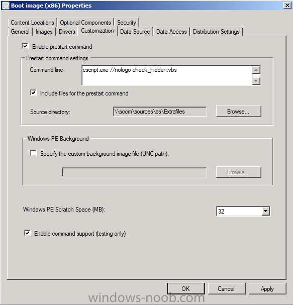

Step 4. Add a prestart script to the boot image
Now that we've injected our needed script, we need to add our prestart command. To do that bring up the boot wim properties and browse to the Customization tab, fill in the details
Command Line:
cscript.exe //nologo check_hidden.vbs
Include files for the Prestart command:
\\sccm\sources\os\extrafiles

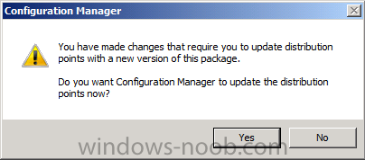

Click Apply, and OK and answer Yes to the Distribute Content question.
you have made changes that require you to update the distribution points.png
continue through the wizard until completion.

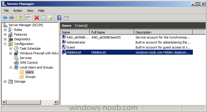

On a suitable server (I used the Configuration Manager primary server in my lab, in production you may want to separate it), create a local user called HiddenList with a password matching the one in the check_hidden.vbs file downloaded in Step 1 above.

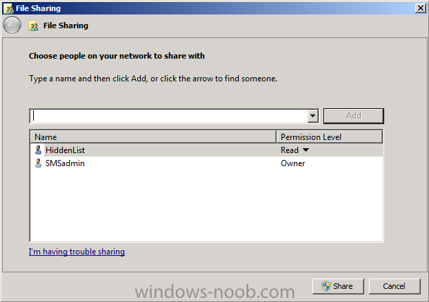

Next create a folder called Hidden$ and share it, grant the local user HiddenList read access to the share.

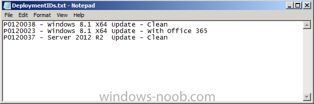

Step 6. Copy DeploymentIDs.txt to the hidden share
Copy the DeploymentIDs.txt file downloaded in Step 1 to the hidden$ share, edit the file in notepad making sure that it includes the DeploymentIDs and friendly name of the Hidden Task Sequences you have deployed in your environment. The Deployment ID value of a task sequence can be found by looking at Step 8 of this post. This text file will be the 'template' that is shown to the end user so make sure to enter the correct values.

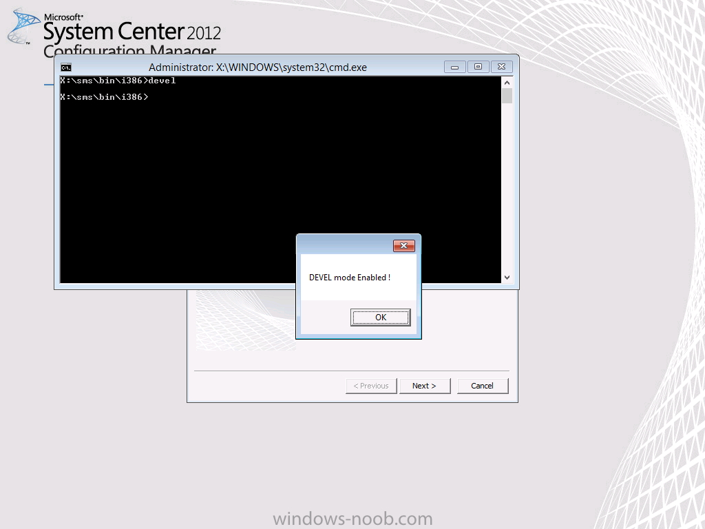

Now everything is in place to test out the theory above. So PXE boot a computer and when you get to the PXE password screen, before entering the password press F8 and type devel. If you followed the guide above you should see a popup telling you that Devel mode Enabled.

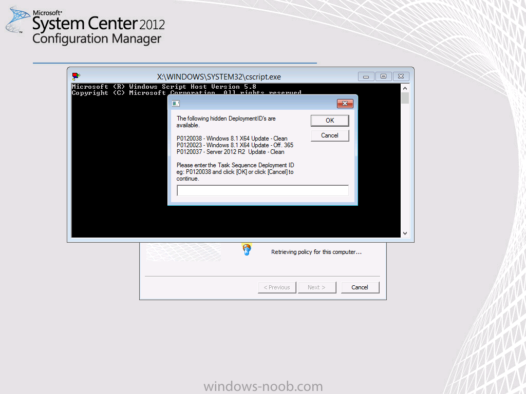

Click Ok and close the command prompt window. Enter the PXE password and press Enter. The prestart command in the boot wim should display the following prompt.
Note: if you didn't enable Devel mode above then it won't popup the prestart prompt at all. That is on-demand in action!

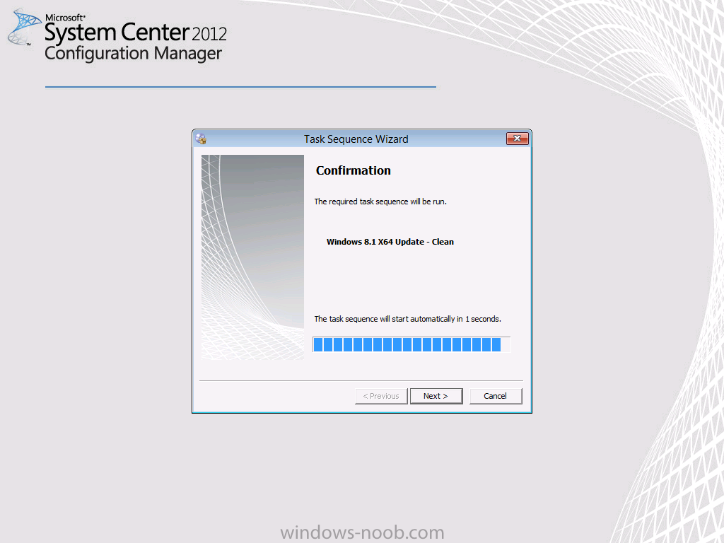

after typing in your deploymentID and pressing enter you should see the following
Success !
