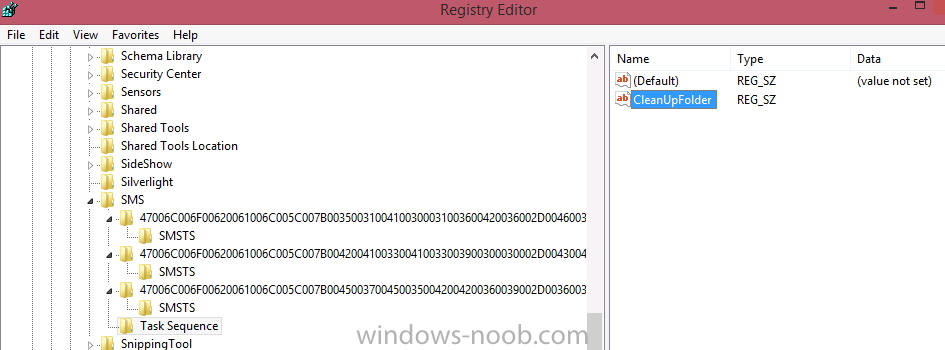

Does your install account have Administrator access? From your logs, there are access issues with the registry. "RegQueryValueExW is unsuccessful for Software\Microsoft\SMS\Task Sequence, SMSTSEndProgram" and "Failed to open key Software\Microsoft\SMS\47006C006F00620061006C005C007B00350031004100300031003600420036002D0046003000440045002D0034003700350032002D0042003900370043002D003500340045003600460033003800360041003900310032007D00\SMSTS" tell me that the key doesn't exist or the account doesn't have access to that area in the registry.
Check to see if the key does actually exist. If it does, then it's a permissions issue - if it doesn't then it's something in your task sequence.

I have attached a screenshot. It exists on my image I created in HyperV. Not sure why it's in there, I didn't use SCCM to do anything with it but capture the image. Should I just delete the registry keys and recapture the image? Will it reconstruct the registry keys when it images the computer?
It shows that System and administrator have special permissions on all of these keys.
