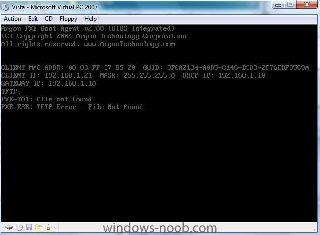

i'm trying to deploy a windows vista x64 dutch version (downloaded from MSDN) so this version have multi versions.
so here is the story i'm trying from a month ago and not luck. the stuation is server 2003 english version x86 and vista x64 version to PC x64 compatible,
i followed wds guide on this site and everything went well accept the booting on the pc. i get ip address from my DHCP and it follow a with this error:
PXE-T01: FILE NOT FOUND
PXE-E3B: TFTP ERROR - FILE NOT FOUND
see picture above
and then nothing happening further
does anyone know a solution or does anyone this have same problem
thank you and sorry for my english

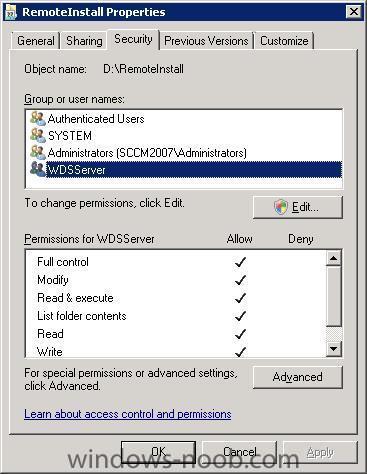

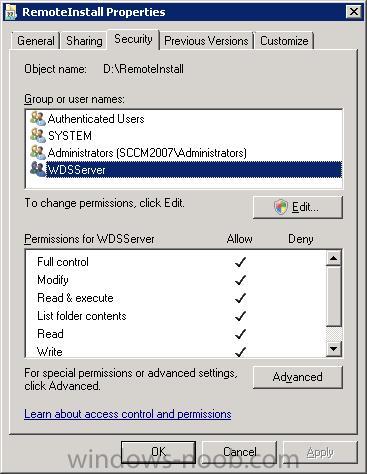

your problem is either a permissions problem or a mis configuration..
right click on your RemoteInstall folder in explorer and click on it's properties
you should see an entry in there for WDSServer and it should have all rights
if it doesn't then the WDS installation has failed and you can try adding them manually, or remove WDS, reboot, remove the remoteinstall folder, and reinstall WDS
it is not a normal user account, it is a service created during WDS intsallation.
please uninstall WDS, reboot, remove the remoteinstall folder, reinstall wds and check again
