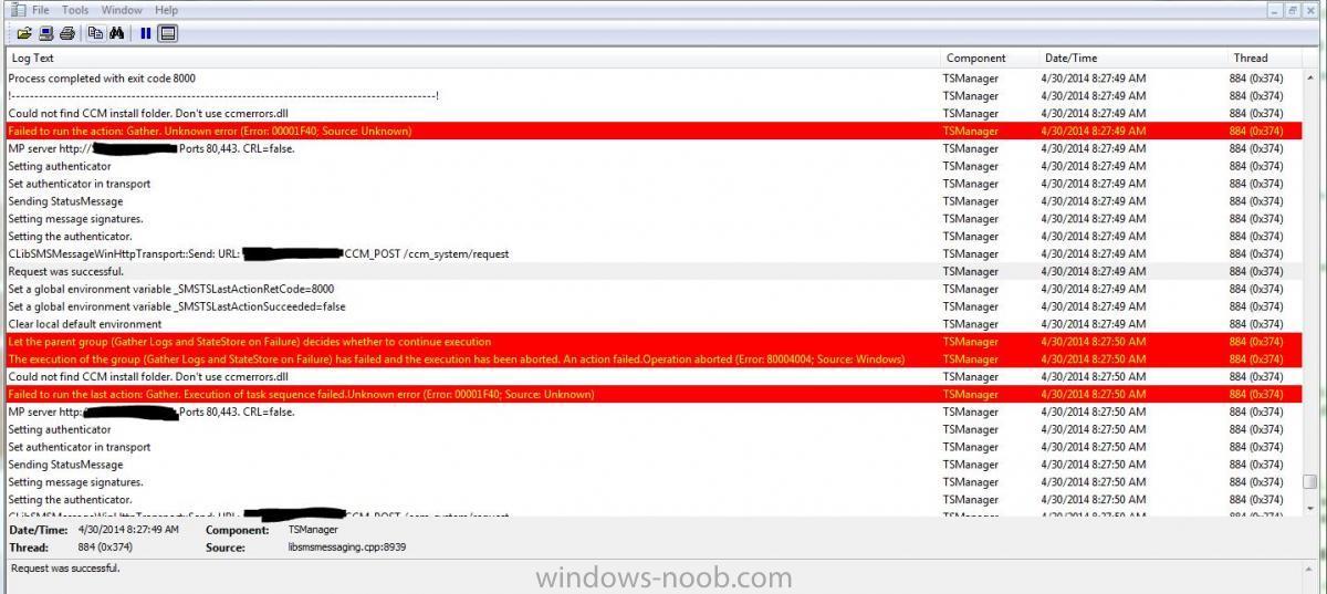

Config_Mgr_noob Posted April 30, 2014 Report post Posted April 30, 2014 Hi, I keep receiving a 0x00001F40 error message when attempting to use OSD from an MDT task sequence that is integrated with my SCCM 2012 server. When I look into the smsts.log file, it is pointing to the "Gather" task step that points to CustomSettings.ini and my unattend answer file that I imported from my SCCM OSD task sequence. Would anyone know what the issue might be? Is it because I'm applying the task sequence to a new PC from the box and its trying to gather local data? If so, can I skip all the Gather task? And by doing so, where would I indicate my answer file? Quote Share this post Link to post Share on other sites More sharing options...
Peter van der Woude Posted April 30, 2014 Report post Posted April 30, 2014 It seems to be failing somewhere else first. This is an log file collecting step that it will perform when something else failed. Quote Share this post Link to post Share on other sites More sharing options...
