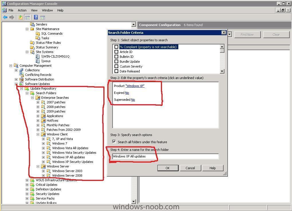

I set my search folders up as follows, this way i get to see/pick whatever updates I want, for example, if i want the service packs i can take them from the OS All Updates search, and so on
does this help ?
