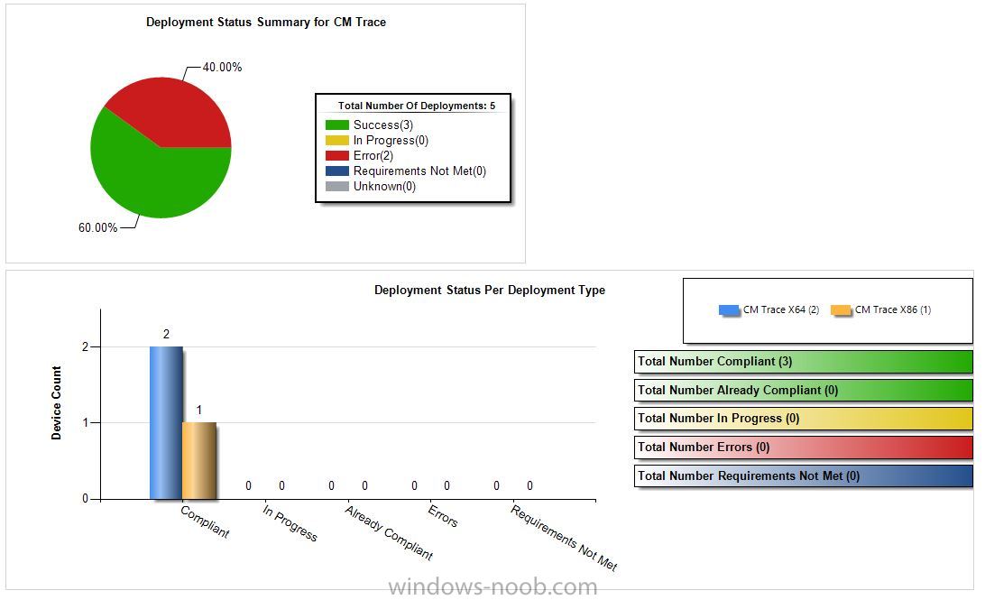

I created a new application for CMTrace (just copies the exe to the system32 folder). Pushed this out to 5 computers to test. It successfully installed on all 5 computers. However after about 2 hours I checked the report again and it is showing that there are 2 errors now. I have confirmed that all of the computers have the exe in the correct location.
I also noticed that in the report, it shows a total of 5 deployments. However in the device count portion of the report it shows 3 successful and 0 errors. See attached.

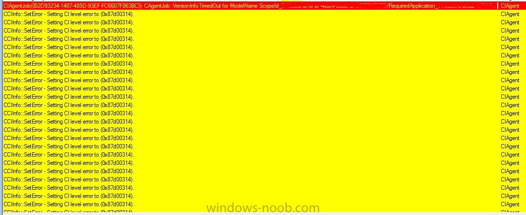

Get the Application ID from the error line in the CIAgent.log and look up the application in the console. Edit the application by changing something, for examle the comment field. Save the changes and manually delete all Versions in the version history excet the newest. Update the distribution points. If the Application is referenced in any task sequnce, remove it from the task sequence and add it again.

Actually it took me some hours to figure out what was going on. Digging through all server and client logs. The only error i could find was the ciagent log error. So it was clear that the client was receiving a wrong policy for an application revision that wasn't even existing anymore. Since all clients together suddenly got this error from one day to another, the only remaining suspect was the maintenance task.
