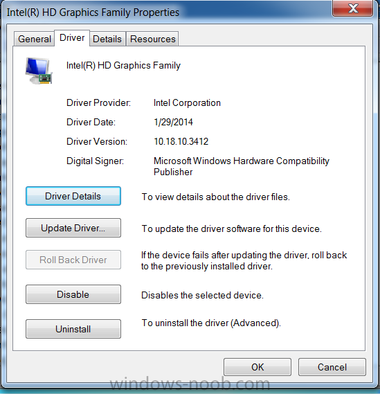

Once the CD OSD is done and I am in Windows, Device Manager tells me that Intel HD Graphics is installed, and version 10.18.3412 (see attached).

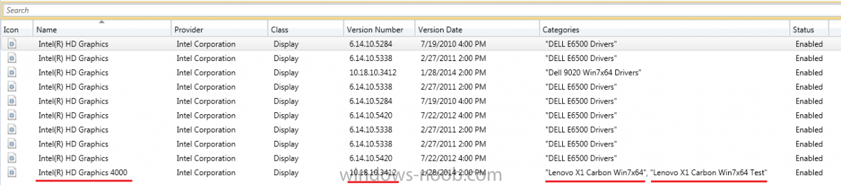

I have rebuilt the USB media several times, trying to take a 'clean' approach when doing this. I have been deleting all drivers in the Lenovo X1 Carbon Win7x64 category out of config manager, deleting all driver files out of the folder ...sources\drivers\Lenovo X1 Carbon folder on the SCCM server, as well as the 'package' folder it creates, and re-uploading the driver fiels to the .../sources/drivers/Lenovo X1 Carbon folder, and re-importing them into config manager.
I have taken a CD based deployment that worked well, and uninstalled the video drivers, and rebooted so it loaded with Standard VGA adapter 800x600. I pointed device manager to ...\sources\drivers\Lenovo X1 Carbon where I have a few subdirectories (Win7x64, Win7x64 Test, as well as extracted video drivers from Intel, and extracted video drivers from Lenovo) and said 'search this location and all subfolders for a driver' to see which one it would pick. The answer - it picked Intel driver version 10.18.10.3412 - the one assigned to the task sequences that I have been applying.
I don't believe so - the screenshot in post #21 shows a search for all drivers with 'graphics' in the name. You can see that the previous administrator had added like 10 drivers for the Dell e6500 laptop...I'm sure that deployment went well, but I have started from scratch a few times here paying careful attention to which drivers I was including. I even tried the ConfigMgr driver packages directly from Lenovo. I don't think this is the case of the 'wrong' driver....there has to be a conflict elsewhere :huh:
