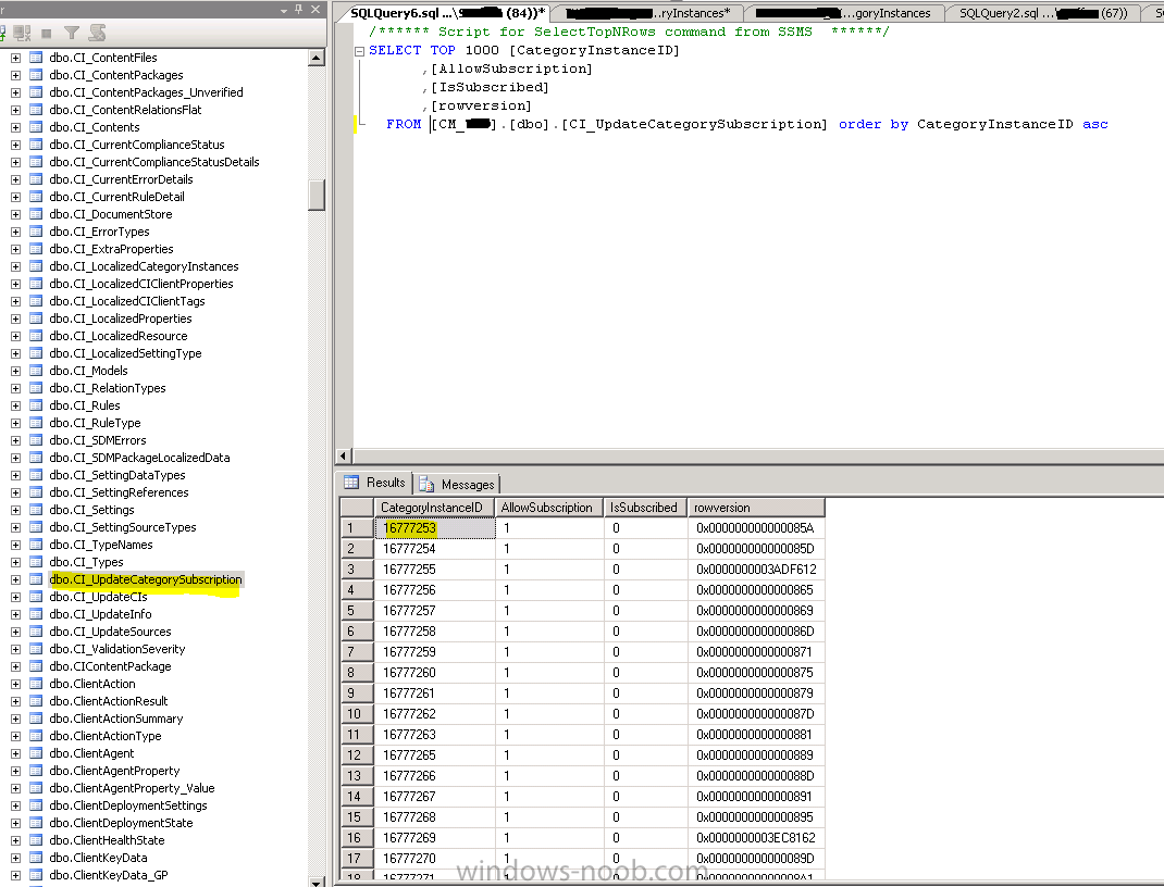

As seen in this picture alle the Update Categories marked with yellow has AllowSubscription = 0
and line number 11 starts with 16777253.

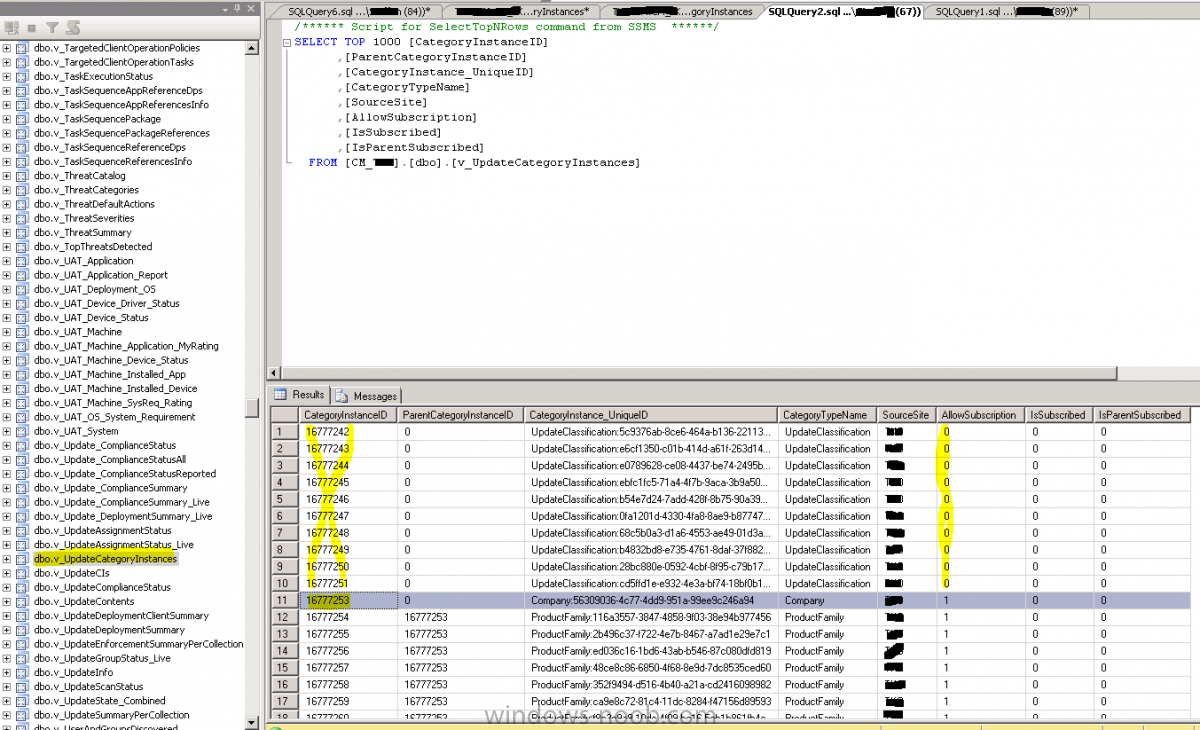

And seen in this picture, line 1 is referring to 16777253 and none of the update classifications. So perhaps some ugly thing has happened in the database.
