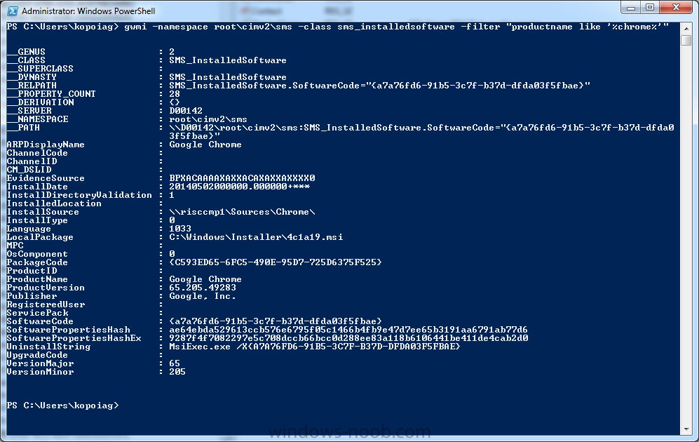

I am usually just running a simple powershell command to ge the Product ID which will be the SoftwareCode property in the output.
gwmi -namespace root\cimv2\sms -class sms_installedsoftware -filter "productname like '%part of the name here%'"
If there is no valid value in the Softwarecode property, for example when the Setup is a freeware installer like "Inno Setup" (PDFmaker etc.), go for the registry like Shawn mentioned it and chose the DisplayVersion property. In your detection rule (registry) make sure to use "Version" instead of "string" and "greater than or equal to" instead of "equal". This will save you some trouble when you are using "supersedence" while testing the new applications.

Peter33 has an interesting suggestion. I am very interested in using Powershell as much as I can, I think its a great language that all systems admins should know and am trying to use it as often as I can. I ran this command looking for Chrome (see attached for sample output) and a few other apps and it worked great! With SQL, as with the registry method, there were TONS of entries. I am guessing that any of these could work, but will require some testing.
