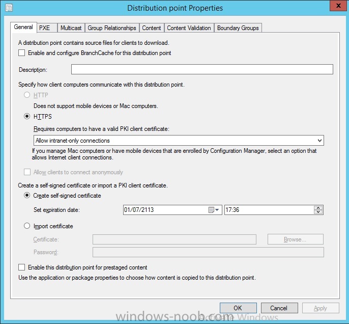

NEO-BAHAMUT- Posted July 10, 2014 Report post Posted July 10, 2014 Edenost - Ok I installed BITS on my client server and this has not fixed the issue. I.hn.yang - How do you mean how is my DP configured? Is there a certain page I should be looking at. When looking at Administration > Servers and Site System Roles my SCCM server is the distribution point I haven't changed any settings in here and they are setup as default. See screen shot for General settings. Quote Share this post Link to post Share on other sites More sharing options...
l.hv.yang Posted July 10, 2014 Report post Posted July 10, 2014 Specify how client computers communicate with this distribution point: HTTPS requires computers to have a valid PKI Client Cert....in my DPs i have it set to HTTP. May be worth looking into since it seems like the PC can't reach the distribution point. Not 100% sure though Quote Share this post Link to post Share on other sites More sharing options...
NEO-BAHAMUT- Posted July 10, 2014 Report post Posted July 10, 2014 How can I set it to http? I did see this and wondered if this could be the issue. However it seems to be greyed out for me and I'm unable to change it? Quote Share this post Link to post Share on other sites More sharing options...
l.hv.yang Posted July 10, 2014 Report post Posted July 10, 2014 Administration > Site Configuration > Sites > Right Click on your Site name and choose properties. Click: Client Computer Communication and select "HTTPS or HTTP" , click OK. Go back to your distribution point setting and the option should no longer be greyed I'll bet when you installed SCCM initially you had selected HTTPS at the setup installation. Quote Share this post Link to post Share on other sites More sharing options...
