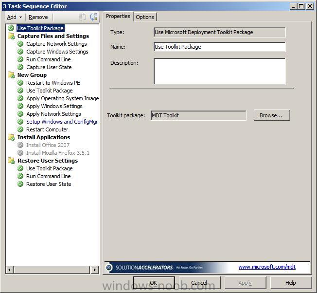

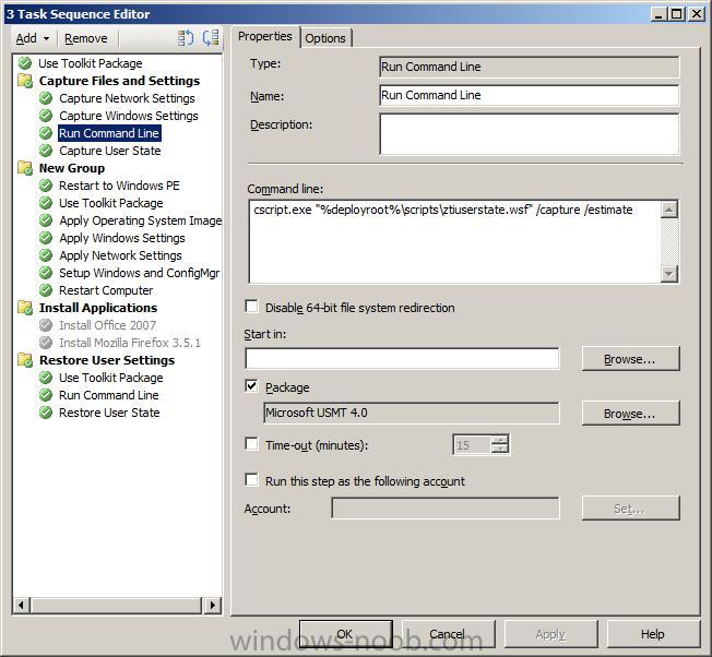

Start of your new Task Sequence with Use Toolkit Package and specify your MDT Toolkit package, capture your Windows and Network settings, then add a Run Command Line task to look like this:
Make SURE that you have both the /capture and /estimate switches as it will not work correctly otherwise. Also make sure that you check Use Package and use your USMT package. DO NOT check the box to run as a different user as in my testing it caused cscript.exe to get caught in a loop and would never complete running the script.
Next add a Capture User State task, I just left it at the default options.

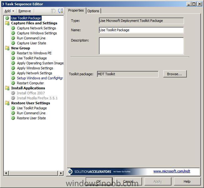

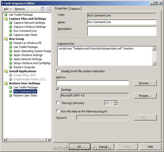

Create the rest of your task as normal until you're ready to restore the user state. Again, we want to use the toolkit package, then run a command line.
Again, make sure you have it set up just like in my screen shot or this will not work if you have local computer accounts on the target system other than the local admin account. Make sure that you have /restore on the end of the command line, you specify your USMT package and do not check the box to run as a different user. It again causes cscript.exe to get caught in a loop.
Add your last task of Restore User State, check the box to restore local computer user profiles and type in a password for them. I know that we edited the ZTIUserState file to restore those accounts, but I tried it with just the edit and not this option checked and it failed on me.
After this my tasks ran flawlessly and I was able to deploy Windows 7 to my target systems on my test network in less than 20 minutes with user state backup and restore.
