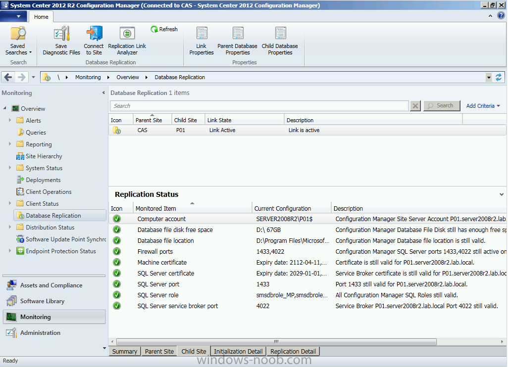

Whenever I run Replication Link Analyzer between my CAS and Primary Site, I receive this error message:
But I don't see where the conflict is.
The Parent Site uses 4022 while the Child Site uses 4023.
What is conflicting? How should I resolve it?
Thank you.
in my Lab environment, both CAS and PRI are running on the same port 4022 as shown below, is this also a lab environment you've setup, if not, why did you install a CAS ?
CAS
Primary
