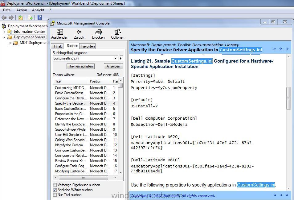

Peter33 Posted August 1, 2014 Report post Posted August 1, 2014 Well, the MDT itself has actually a pretty good build in help. Just search for customsettings.ini in the help topics. Also you should not miss out the sites of Johan Arwidmark and Mikael Nystrom. http://deploymentbunny.com/category/mdt/ http://www.deploymentresearch.com/Research.aspx?Search=customsettings.ini&SearchType=Keyword These two guys know what they are talking about. If you ever get a chance to attend one of their training sessions, go for it. Actually you can also watch some of their sessions online http://channel9.msdn.com/Events/TechEd/NorthAmerica/2014#fbid= Quote Share this post Link to post Share on other sites More sharing options...
